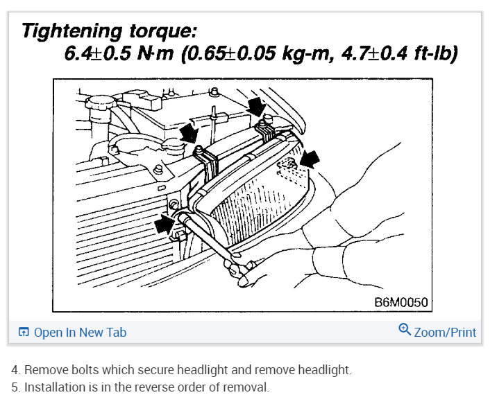

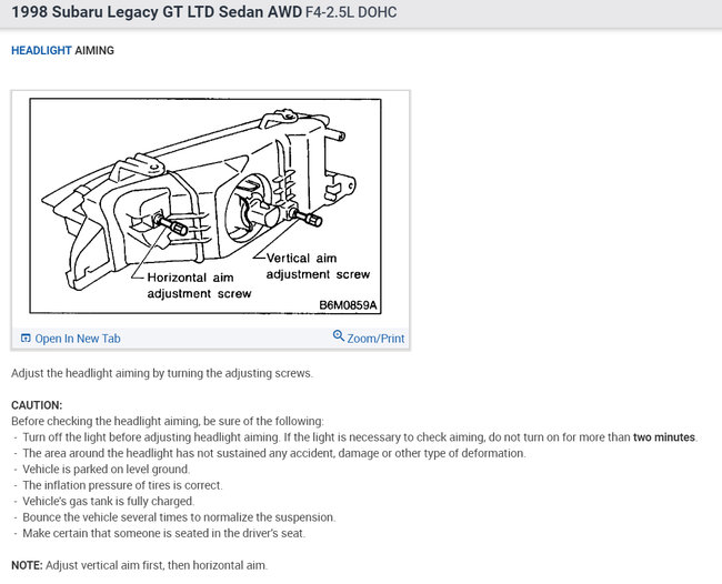

How do I adjust the aiming of the headlights? Right now they light up the ground in front of the car for only about 5 feet. I need to raise the aim point.
Dec 27, 2007 at 11:03 AM
PICTUREMOM2
Park the car on a flat driveway facing the garage door so you can get the lines right. here are diagrams below to show you how to adjust the headlights. Check out the diagrams (Below). Please let us know if you need anything else to get the problem fixed.
