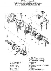

I was changing the balljoint on the right side of my '98 Legacy Outback. When the balljoint came out of the control arm it caused the driveaxle to pull out of the differential. Upon closer inspection, I discovered that instead of the driveaxle having a splined shaft that goes into the differential like my previous car, the shaft goes over a splined shaft sticking out of the differential and is held in place with a spring pin. Unfortunately the axle was still connected to the shaft with the pin and it was the shaft itself that pulled out of the differential. Is this as bad as it seems? Is it something I can fix or is my differential shot? Any advice would be greatly appreciated. Thanks.

Hi JMaybray, Thank you for the donation. If item # 14 has been dislodged, it is not a major problrm. It is held in place by a C clip as with other models. Only difference is that it has an additional extended part. Check the C clip condition and replace it if necessary. Reinsert the shaft into the differential and ensure it clicks in securely so that the C clip is seated correctly.

Thanks, I'll try that. I was fearing the worst.
