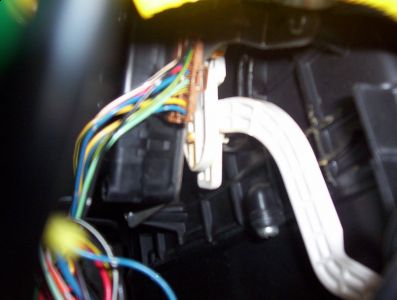

I had already asked Ken about this problem originally and I received some feedback but still can't figure out what the problem is. The care would not start at all at times. We determined the problem might be the starter or the battery. She had her starter replaced and found out her battery was bad as well, so we replaced that as well. Now the care still does not start ocassionally. The noise I originally askedyou guys about went away, but is back now. I located the origin of the noise, and have taken a photo of it, and am forwarding it to you so maybe you can tell me what it is, and if this may be the problem. Also the other day the car started making buzzing noises, the CD player began spitting out CD's, really weird. She put the key in the ignition, and when the key went half way in, the buzzing stopped, and when it went all the way in, the buzzing started again. I am forwarding you a photo of the part under the hood, and see if you can tell if this may be the problem. The service tech I called at my subaru dealer told me it could be the fuel pump relay that could be bad, and it could send codes all over the place and cause this problem. Is this the fuel pump relay in this picture? He said it was an easy and cheap fix. What do you think? Any additional input would be appreciated. Thanks
[img:15128a180b]http://www.2carpros.com/forum/automotive_pictures/17851_relay_1.jpg[/img:15128a180b]ddd

What you got there is the mode actuator for AC. The fuel pump relay is underdash far left has 4 wires to it. Should be couple more relays there also.

That mode accuator just has this muffled thump to it, as best as I can describe it. zI watched it while it was making the noise, and it looks like it's trying to turn the attached white curved piece, but it's like it's stuck, as best as I can describe it guy. It's intermittent. What does it actually do, and does it need to be replaced? I don't think this would cause the car to not start, if it's AC related, right?

Does car have anti-theft ? if yes interuot relay is above joint box left side dash. So buzzing not coming from mode actuator ? if yes where is buzzing comming from?

yes, car does have anti-theft. The mode accuator makes the muffled thumping sound. The buzzing she heard the day the electronics went nuts is coming from under the dash, on the left side, so that is probably the interruptor you are talking about. Today the car did it again. Turned the key, no cranking, no clicking, absolutely nothing. All the electrical components came on, lights, radio, dashboard lights, etc, but no engine crank, or even a clicking, nothing. I went out and I disconnected both cables from the battery, waited about a minute, and reconnected the neg first, then when I reconnected the positive cable, the alarm didn't go off, as it usually does when you disconnect and reconnect the battery cables. I did this twice and it still didn't go off. I thought it strange. After I reconnected it she turned the key and it started. I also noticed that even when the alarm is off, when it is parked in the garage and the alarm is not necessary, the red light for the alarm still blinks, as if it is activated, and after you turn if off, to drive the car, the alarm light continues to blink as if it were still on. Do you think it is possible that the security system has some kind of electrical short or other problem that is causing all of this, because the noise coming from the mode accuator for the a/c is unrelated to the starting problem, it just happened at the same time. I think I am going to disable the alarm system and see what happens, because she had the car diagosed at a local auto parts store, and the only code it registered was cylinder 4 misfire, which we know it does, because it does this ocassionally when she drives on the interstate. You would think a problem like this would register a code, but it doesn't.
I promise not to bother you guys anymore with this, but does my theory that there could be a problem with the anti theft system make sense? When this happens, it's almost as if the system detects a theft of the vehicle and kills the ignition. Does this sound like something feasible?

Yes I agree anti-theft is culprit testing is needed. Do you have acess to info? if not click on site at bottom of reply manuals. And for @$10 you can get instructions downloaded on your computer. As for AC actuator run the system through modes see if they function.
