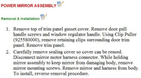

Hi guys - I need to replace the passenger side view mirror (its electrical). A friend's kid hit it accidentally with a basketball, now the housing is cracked. I have the part & am looking for some instruction on replacing it. Is it fairly easy? Can you advise me please? Thanks a whole lot - Lisa.

https://images.2carpros.com/forum/automotive_pictures/55316_95legacymirror_1.jpg
