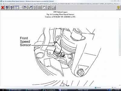

1995 Subaru Legacy ABS sensors
SEXYSTEVE007
  • 1995 SUBARU LEGACY
  • 4 CYL
  • 4WD
  • 170,000 MILES

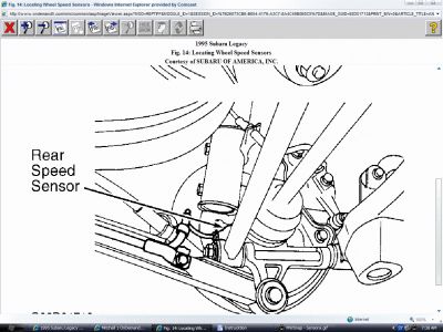

Hi there Both my rear abs sensors need replacing as my light is coming on more and more. How do I replace these as like many of other people im a bit short on spending $750 to replace them?
Tuesday, May 27th, 2008 AT 12:10 AM
MERLIN2021
  • 17,250 POSTS
First, remove the rear seat, unplug the sensor, pull wire to the outside, at the wheel, remove the screw, pull sensor out...install is the reverse!
https://www.2carpros.com/forum/automotive_pictures/62217_Sensora_1.jpg
https://www.2carpros.com/forum/automotive_pictures/62217_Sensorb_1.jpg
