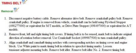

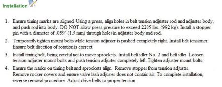

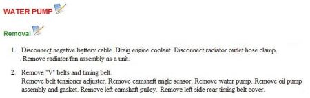

where is the water pump and how hard is it to repace it?

biggest part of the repair is removing the timing belt.. it takes around 3 labor hours for an experienced tech to make this repair. . would you like replacement steps to see if you think you want to try the repair on your own?

would you like replacement steps to see if you think you want to try the repair on your own?...would you please that would be very helpful. Thanks.
