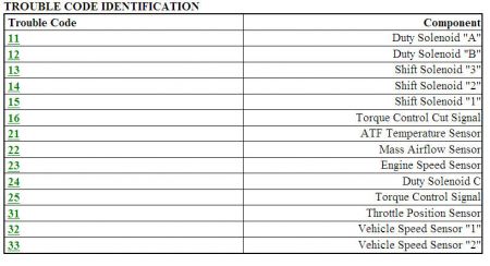

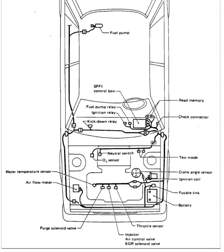

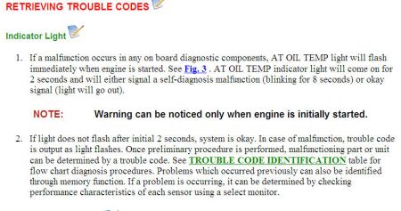

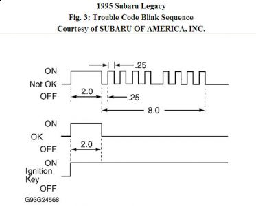

Hi John, I apologize, I shouldn't jump into conclusions. The solenoid I was questioning was the Duty solenoid "A". Let's go back and check for codes before anything is condemned or replaced.
https://images.2carpros.com/forum/automotive_pictures/30961_Zsub_1.jpg
https://images.2carpros.com/forum/automotive_pictures/30961_Zsub1_1.jpg
https://images.2carpros.com/forum/automotive_pictures/30961_Zsub2_1.jpg
If you can test the line pressure, that may also aid in what is happening.
