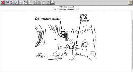

I have a 1991 Subaru that is only sparking on one of the two coils. Coils pack checked and is good. Ignition Control module is good. Wiring from ICM to coil pack is good. Any suggestions?
Jan 6, 2010 at 10:30 AM
  • 75,988 POSTS
Check and test the crank angle sensor at front center of engine on oil pump see below
https://images.2carpros.com/forum/automotive_pictures/12900_crank_angle_sensor_1.jpg
