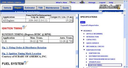

1990 Subaru Legacy timing settings
1990 SUBARU LEGACY
15,800 MILES • 4 CYL • 2WD • AUTOMATIC
BA420FREERIDER
I recently put a new water pump on my car and now it won't idle I need the timing settings to try this but can't find a manual to set it. What is the timing setting for my car

See below
https://images.2carpros.com/forum/automotive_pictures/12900_timing_7.jpg
