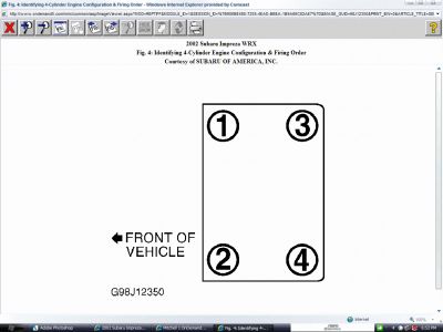

I need to locate cylinder #3 on an 02 Impreza wrx. I have a misfire code in this cylinder and am not sure whichis #3.

Front to back 1, 2, 3, 4...or left to right!

Pm answer: thanks for the quick response, but I am still confused. The engine sits conventionally in the engine bay. So, #3 is where? Sitting in the drivers seat, L/f, R/F, etc.
Look for the fan belts, that end is #1 then 2, 3, 4, OK?

the #3 cylinder on a wrx is located in the back on the passengers side.
it goes
back
3 1
4 2
Front/bumber

https://images.2carpros.com/forum/automotive_pictures/62217_FO_7.jpg
Never sdeen anything like it...
