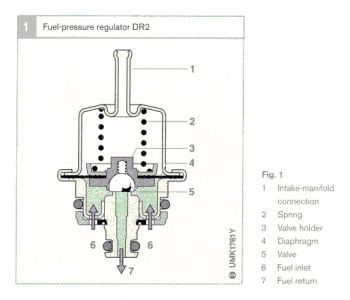

I'm having trouble understanding what a "fuel pressure regulator" does. I know it regulates fuel but why and h0w? what is the purpose of the vacuum line attached to it?

The fuel pump would provide a very high pressure and the regulator controls the pressure by releasing excessive pressure through the return hose back to the fuel tank.
There is a pressure release valve in the regulator and when excessive pressure is present, the valve would open to allow excessive fuel to return to the fuel tank. Newer models would have the regulator intank and does not work on vacumns.
The vacumn hose is for reducing the pressure of the regulator control by lowering the pressure required to open the relieve valve. It is similar to vacumn assist as used for the power brake booster. At idling when less fuel is required, vacumn is greater and this would reduce the pressure in the system as the regulator vacumn has more assist.

"At idling when less fuel is required, vacumn is greater and this would reduce the pressure in the system as the regulator vacumn has more assist."
having a little trouble understanding......at idle the engine spinning at lowest rpms.....how is it that vacuum pressure is greater?.........what is the purpose of the vacuum, to suck out the air from the spring loaded side of the regulator? or is the vacuum suppose to hold the spring down?

Vacumn in intake manifold is high at idle and that is where the vacumn hose is attached to.
When idling speed is increased, the throttle is opened more and that would cause the vacumn to drop.
The vacumn is to counter the spring so it weakens the spring pressure on the pressure valve. this would lower the pressure in the system.

Intake vacuum exists in the intake manifold as a result of the pumping action of the engine's pistons and the restriction created by the throttle valve.
so when the car is at idle the throttle plate is closed because no one is steping on the acceleration. The piston on its intake stoke sucks in air. n0w being that the plate is close it sucks in whatever air thats before the plate.....now is the the vacuum? so the question is the vacuum suck the pressure out of the regulator?
Now being that the fuel pressure is higher the fuel is able to push the spring up and allow the extra fuel to enter back in the tank.

In the pressure regulator there is a diaphragm with a spring pushing against it to close the pressure valve. The spring is preset to release the fuel pressure at a preset value.
When vacumn is applied to the diaphragm chamber, it would counter the spring tension and thus lower the pressure required to open the relieve valve. This would result in a lower pressure when vacumn is high, ie at idling, when decelerating.

so.......the question is the pressure would be low at idle because the throttle plate is closed because no one is stepping on the accelerator? in picture 1.....with the throttle plate open. why is the fuel pressure regulator closed. Is air fr0m the intake passing through the vacuum line into the regulator to hold the spring closed?

The spring is the main pressure control. It is pretensioned to push the diaphragm to close the pressure port when no vacumn is applied to vacumn chamber.
Vacumn is to counter the spring tension, as it is on same side of vacumn chamber, so that a lower pressure would be able to push the pressure port open and this would lower the line pressure.

thanks......so much "KHLow2008"......for your patients........i finally understand

Fuel Pressure Regulators An essential part of the Fuel System, the Fuel Pressure Regulators' sole purpose is to maintain fuel pressure at a constant differential to manifold vacuum under all engine load conditions. The fuel pressure regulator is responsible for controlling the set fuel pressure of the system. On returnless fuel systems (RLFS), the pressure regulator is part of the in tank unit installed in the fuel tank. The fuel rail pressure is maintained at a constant level with reference to the surrounding pressure. This means that the difference between the fuel rail pressure and manifold pressure is not constant and must be taken into account when the injection duration is calculated. The fuel pressure regulator (Fig.1) is of the diaphragm controlled overflow type. A rubber fabric diaphragm (4) divides the pressure regulator into a fuel chamber and a spring chamber. Through a valve holder (3) intergrated in the diaphragm, the spring (2) forces a moveable valve plate against the valve seat so that the valve closes. As soon as the pressure applied to the diaphragm by the fuel exceeds the spring force, the valve opens again and permits just enough fuel to flow back to the fuel tank that equilibrium of forces is achieved again at the diaphragm. Bosch fuel pressure regulators are competitively priced and sold through leading automotive part stockists. Please see our "˜Dealer Locator' at the top of the page to locate you local store
