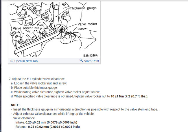

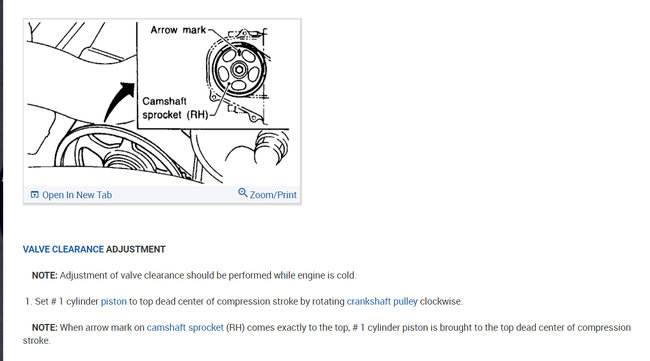

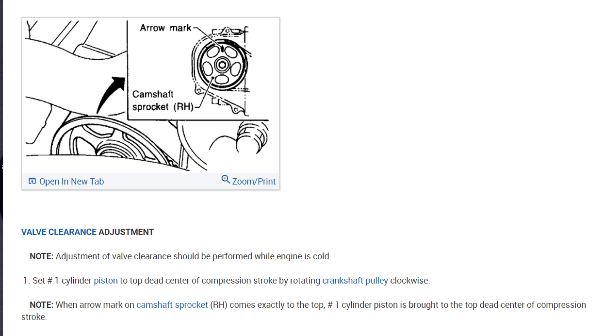

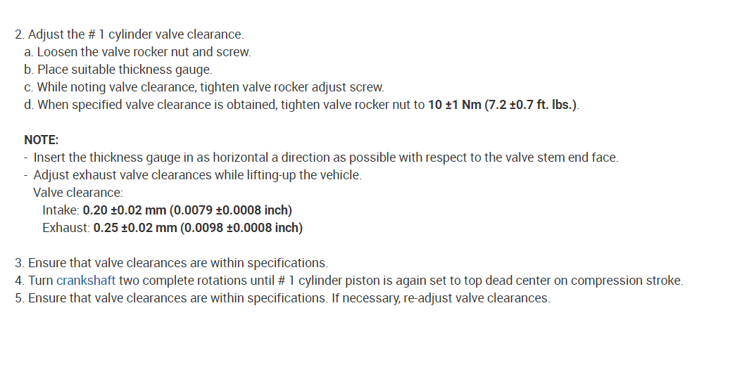

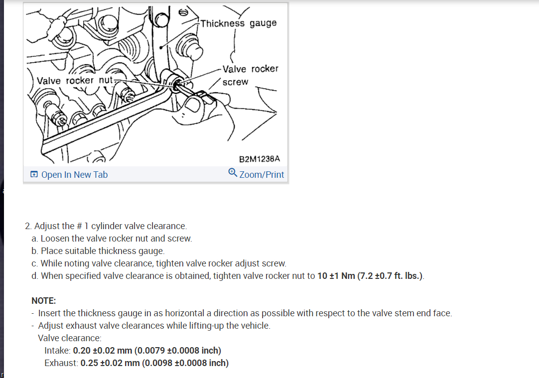

hello 1.5 boxer engine with adjustable valve clearances , do you know the inlet and exhaust (cold) specs . cheers blair
Nov 12, 2009 at 5:28 AM
Good morning,
I attached the procedure with specs for you for the adjustment. Make sure you follow the procedure or you may do valve damage.
Aug 29, 2021 at 6:50 PM
Make sure both valves are closed when you adjust them. Use a feeler gauge to check the clearance. If it needs to be addressed, loosen the lock nut and move the adjuster up and down until you fell a nice drag on the feeler gauge and there is no wobble on the feeler gauge.
Do this to all the valves. Then torque the lock nut to 22 foot pounds.
