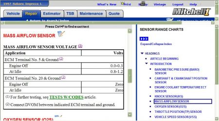

checked diagnostic and came with maf circuit high. the mass air flow sensor cost $205.00 would like to prove that is the problem before ordering the part. is there a way to do this?

Check by doing below
https://images.2carpros.com/forum/automotive_pictures/12900_maf_sensor_2.jpg
