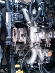

Hi ive got a '96 impreza wrx 2.0lturbo and im going to change the plugs and leads. Ive done this on all previous cars with ease but as the impreza has the boxer lump im baffled as to where the plugs are located. I have been looking around the sides of the block as i take it thats where they are? I cant even find the coil pack to trace the HT leads to the plugs lol. Sorry to bother you with this simple task and thanks.

If you look at the pic I have included you see a wrx engine. Now if you look at the intake runners follow them down and you should find they meet the heads the plugs are down in there. You may have a cover on the top of the engine that will need to be taken off to find. If needed include a pic of what you have and I will look it over.
