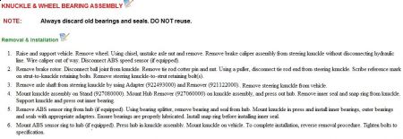

JOCKAMES
How do I R/R front wheel bearings
Mar 10, 2010 at 5:45 AM
BLUELIGHTNIN6
  • 16,542 POSTS
https://images.2carpros.com/forum/automotive_pictures/261618_Noname_1851.jpg
