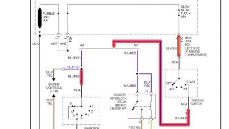

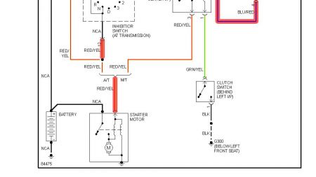

Car will not start. All lights come on but starter or nothing kicks over.
Thursday, July 31st, 2008 AT 4:46 PM
MECHANIC
75,992 POSTS
Make sure the battery is good and connections, check slow blow fuse 5amp,inhibitor switch at transmission and starter motor
