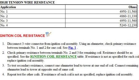

on my car only half my plugs are sparking ive replaced the ignition control module but still only half are sparking please help thank you

https://images.2carpros.com/forum/automotive_pictures/276698_sub_coil_1.jpg
Hopefully this diagnostic aid helps.
