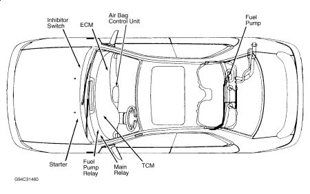

i replaced the fuel pump and my car still will not start the fuel pump isnt even kicking on i was wondering where the fuel pump relay is located i have not been able to locate it

check behind left side of dash
https://images.2carpros.com/forum/automotive_pictures/261618_Graphic_437.jpg
