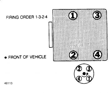

Can you tell me the firing sequence for my 1984 subaru gl?

my diagrams show, if viewed from the front that the distributor in this diagram is rotated 180 degrees where #2 is should be #1, again according to the diagrams that I have from Subaru for an 84 GL, DL, Brat with OHV. OHC is a bit shifted clockwise.
