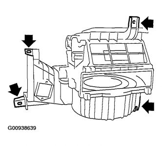

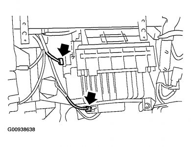

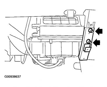

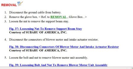

2004 Subaru Forester noise/vibration
2004 SUBARU FORESTER
12,350 MILES • 4 CYL • AWD • AUTOMATIC
SCOTT DENNETT
When the heater/ac fan is on there is a significant rattling,vibration. Doesn't affect the RPMs. On high fan setting the noise is loud, almost sounds like something is caught in the fan. How can I check out the fan assembly?
Jun 6, 2010 at 2:10 PM
MHPAUTOS
  • 31,937 POSTS
fan removal as per Mitchell 1.
https://images.2carpros.com/forum/automotive_pictures/61395_Capture_20.jpg
https://images.2carpros.com/forum/automotive_pictures/61395_sub_1.jpg
https://images.2carpros.com/forum/automotive_pictures/61395_sub1_1.jpg
https://images.2carpros.com/forum/automotive_pictures/61395_Graphic_148.jpg
