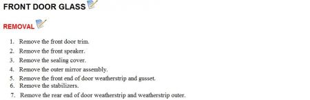

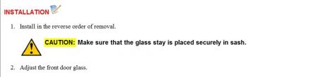

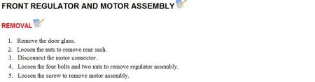

The drivers side window motor is not working (window will not go up). I have found motors on the internet. How do I replace the motor? How do I remove the glass?
