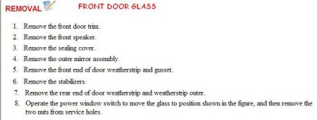

2003 Subaru Forester 4 cyl All Wheel Drive Automatic
trying to replace drivers side power window motor
can't figure out how to take it apart

https://images.2carpros.com/forum/automotive_pictures/261618_Noname_1760.jpg
https://images.2carpros.com/forum/automotive_pictures/261618_Noname2_554.jpg
https://images.2carpros.com/forum/automotive_pictures/261618_Noname3_213.jpg
https://images.2carpros.com/forum/automotive_pictures/261618_Noname4_108.jpg
https://images.2carpros.com/forum/automotive_pictures/261618_Noname5_49.jpg
