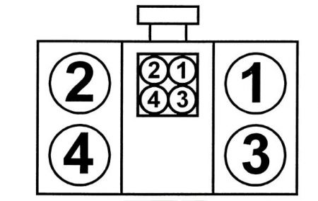

Could you tell me which O2 sensor needs replacing if the code readout indicates "Sensor 1 Bank 2"?
The engine type is EJ253 - AWZVB. Thanks.

Hello Thanks for the donation Sensor 1 refers to the oxygen sensor closest to the engine. Bank 2 refers to the side that the number 2 cylinder is on. Below is a firing order diagram so you know which side is Bank 2 of your engine..
https://images.2carpros.com/forum/automotive_pictures/261618_Noname_282.jpg
You can always test the sensor before replacing it. To learn how to test an oxygen sensor, follow the link below.. https://www.2carpros.com/how_to/how_to_test_oxygen_sensor.htm Thanks for using 2CarPros.com!

So, am I replacing the sensor before the cat conv. or after it?
Mar 4, 2009 at 9:31 AM
BLUELIGHTNIN6
  • 16,542 POSTS
Starting from the rear of the vehicle and moving towards the front, it will be after the converter. One closest to engine.
