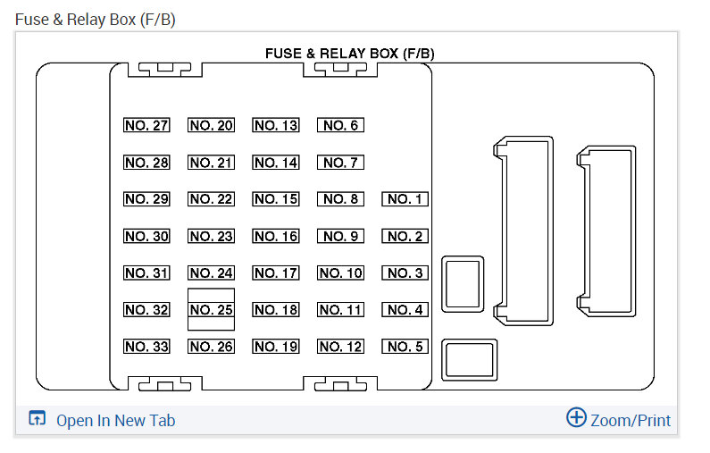

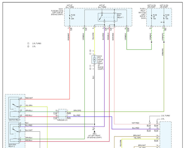

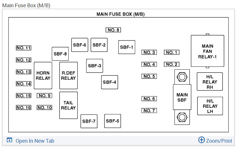

If neither fans are working it sounds like the main fan relay 1 is not working but we should check the fuses (3, under the hood and #26 and #22 inside fuse panel) as well, here is a guide to help you check the fuses and if they are okay, I would swap out the relay.

How are the fuses? do they have power?

Also, I would try swapping out the main fan relay one if the fuses are okay.

That relay has been changed now. I had to wait for a new one before I even messed with it. Subaru has it shrouded right in the fuse box they like to fall apart when removed.

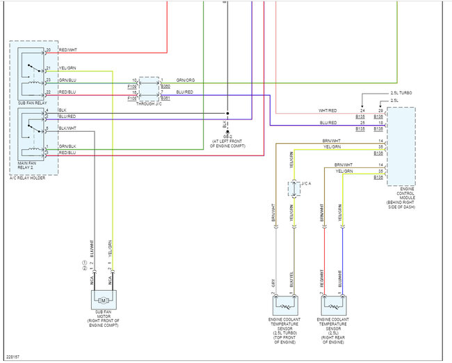

So, does the fan come on when the A/C is on? If not, I would test the yel/grn wire to the fan motor for power with the A/C on. Here is a guide to help:
Please go over this guide and get back to us.
