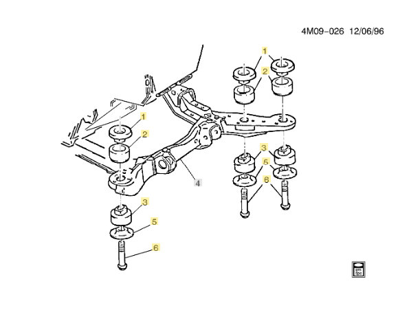

There are 4 bushings at the back of the sub-frame in location by the tires. Out of those 4 I have 2, in the front of those four, that are completely worn out on the top side of the bushings. The rubber on the top side of the bushing on the front passenger side is gone, the washer on the bottom of this bushing has fallen off. The front bushing on the driver side/left side, the rubber on the top of it is very cracked, aged, worn the washer is still there. The other two bushings in this area do not look bad at all and the washers are there, the rubbers/bushings look good. With the other two in the shape, they're in what sort of symptoms, while driving, would this produce? I have no idea the mileage of this vehicle.

Hello AHARTLEY,
Some symptoms of bad sub-frame bushings are:
Vehicle is hard to align
Rattling noises over bumps
Poor handling
Possible pull to one side when braking
The good news is they are still available through GM. If you are going to replace them, I recommend getting them from the dealer. Just make sure to bring your VIN. They are actually really inexpensive.
I have added a picture from my GM catalog for your reference.
I have also added a YouTube video for you on how to replace them that I think will be very helpful:
https://youtu.be/7IA20KgWcrc
If you are going to replace them, I would do all of them and then get it aligned.

Thank you. I have the 2 on the passenger side put in. By the grace of God, the nuts did not come loose nor spin on me, so I didn't have to cut into the body. We'll see on the next two. Thank you.
