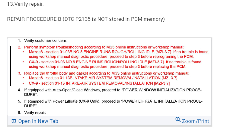

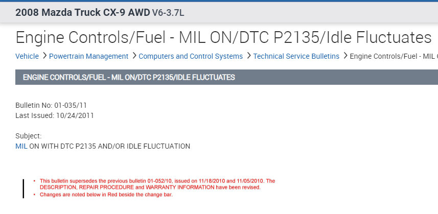

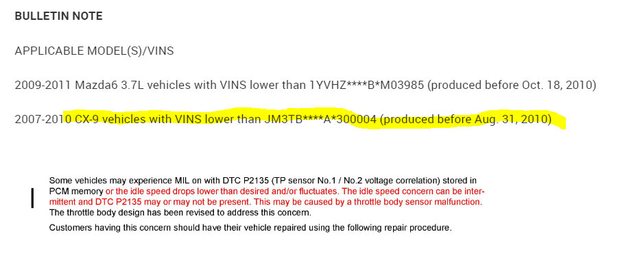

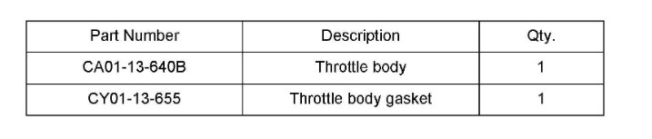

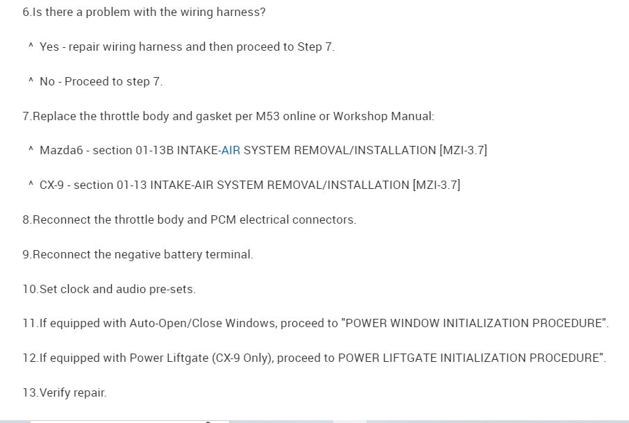

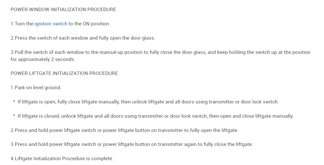

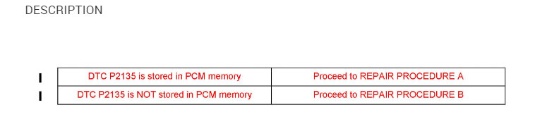

The idle speed issue you described sounds related to the idle air control valve (IAC). The IAC is responsible for maintaining the engine idle speed.
Here is what I recommend. First, check to see if there are any engine vacuum leaks. Check around the intake manifold as well as vacuum hoses.
Here is a link that explains how this is done:

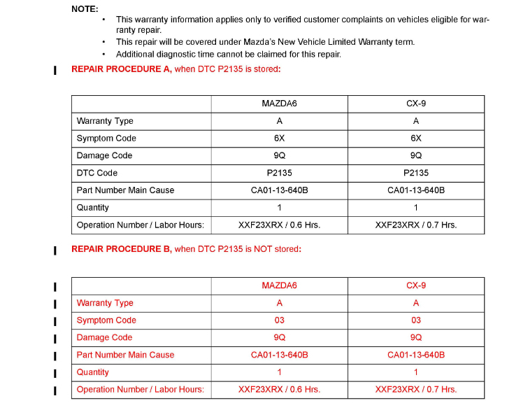

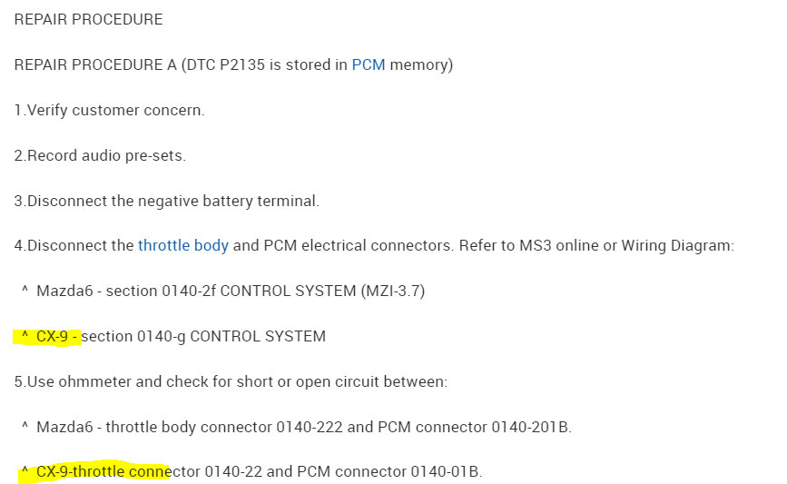

Also, I found a very interesting technical service bulletin that I attached below so you can read it. It deals with the symptoms you mentioned but is limited to specific vehicles made during the production year. Note that it says VIN numbers below a certain number, see if yours is below it.
