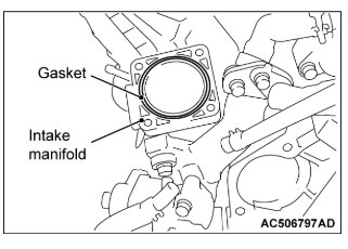

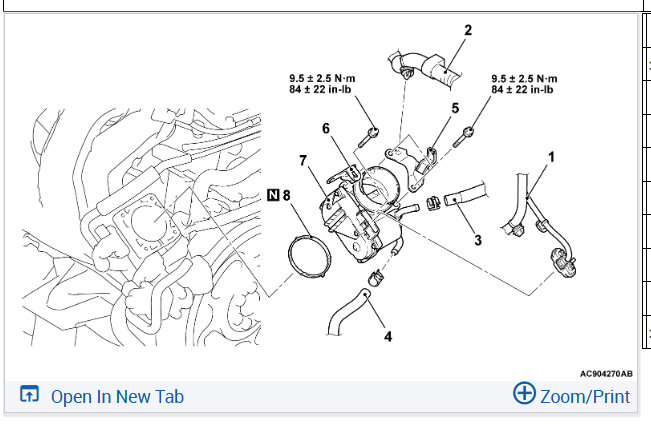

Car stutters sometimes. Recently I noticed stuttering gets worse when defrost is on but not when heat is on. The husband would put it in neutral if at a stoplight and stutter and idling will calm down.
Jan 4, 2025 at 1:23 PM
  • 54,832 POSTS
Yep, when the engine is under load it will misfire because this is when the ignition system is under stress. I would do a full tune up with spark plugs and ignition coils with are a common failure, also I would service the throttle bore, here are two guides to help walk you through the repair and instructions for your car in the images below.
https://www.2carpros.com/articles/how-to-tune-up-a-car-engine
and
2.0L 4-cylinder (4B11) NGK ILKR7E6 (Iridium) 0.039 - 0.043 in (1.0 - 1.1 mm)
2.4L 4-cylinder (4B12) NGK ILKR7B8 (Iridium) 0.039 - 0.043 in (1.0 - 1.1 mm)
Check out the images (below). Please upload pictures or videos in your response of any problems so we can see what to help you with.

TMERRITT
Thank you so much.
I figured it needed a tune up.
In my state a full tune up can be expensive.
I will have them focus on spark plugs and coils .
Jan 5, 2025 at 2:56 PM
  • 54,832 POSTS
Sounds good, I would have them do the throttle bore service as well.
