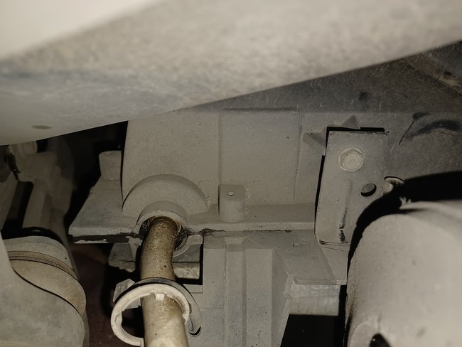

This is where the leak is. Is there a missing seal or something or what would make this leak happen here?
Apr 22, 2022 at 12:56 AM
  • 110,248 POSTS
Is pic 1 going from in front of the engine to the transmission? Also, is the leak right where it starts being covered?
In pic 2, I can't tell what is leaking.

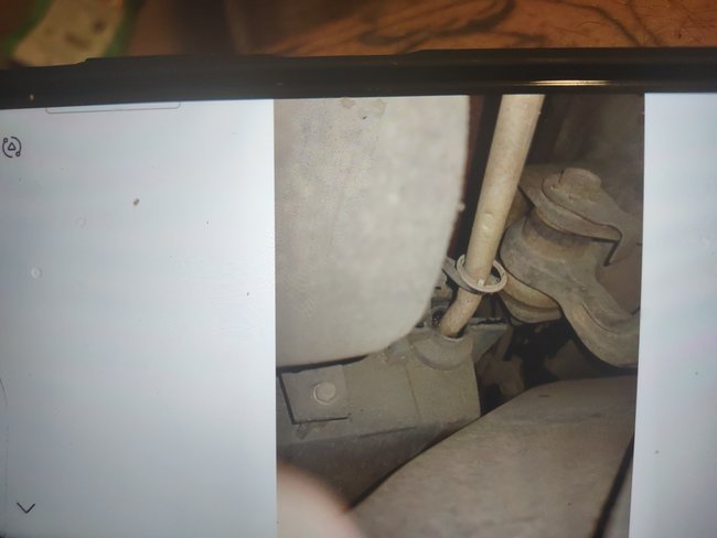

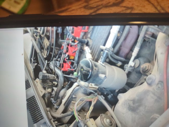

Pic one is on passenger side and goes from transmission to radiator.
Apr 22, 2022 at 11:40 PM
  • 110,248 POSTS

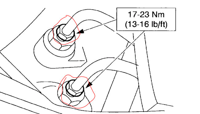

That's a transmission cooler line. There should be 2 of them. One is the supply, and the other is the return.
There are several different ways that can be attached. Some simply screw in, and others are a special connector. I believe this vehicle will have the screw-in type.
Since it's leaking, it could be loose or even have a small pinhole in the steel line. I attached a pic below showing what I believe you will find if you continue following the hose to the cooler. Also, I believe the cooler is not part of the radiator but a separate cooler in front of the radiator.
