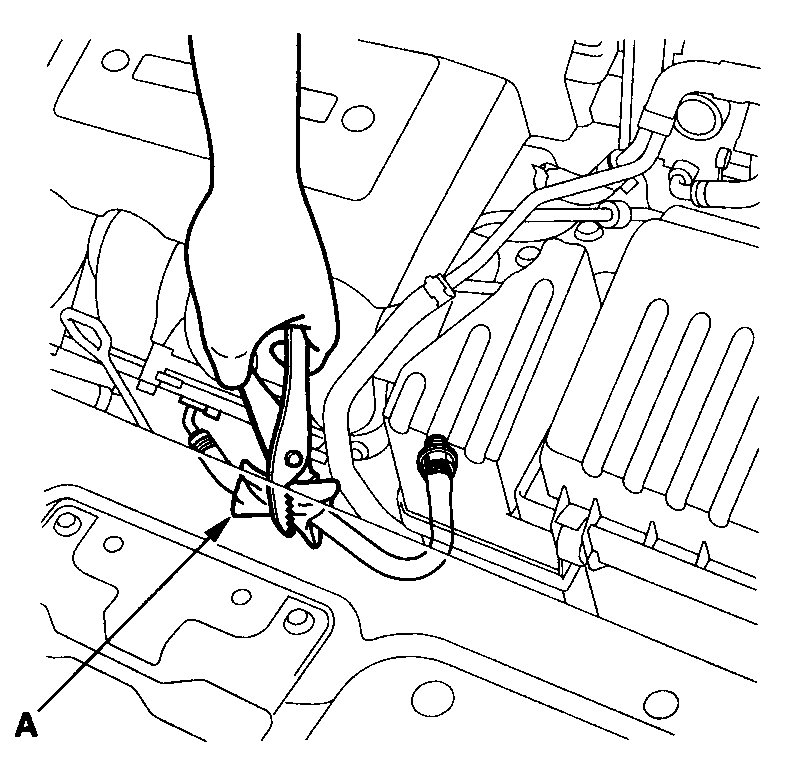

I have a the car listed above Sport model five speed. This car until recently has ran like a dream. It originally started to stutter randomly sometimes when in idle but some of the time at higher highway speeds. I will try to gas it at higher speeds and it stutters and then starts to gain speed.
I have no code thrown and the no oil leaks. The only thing that worries me is after the car is cut off I can hear a faint whistle noise coming from the bay. It doesn’t sound like a boiling noise as it doesn’t have to get hot to do it.
This all leads me to believe it’s something to do with one of a couple things. A vacuum leak? A bad ignition coil pack? Or spark plugs? But I’ve read horror stories that have me thinking head gasket but that seems far too major. Help please!

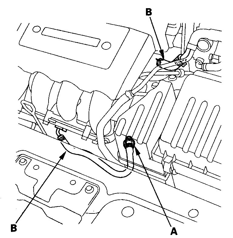

Here are directions for checking the PCV. They are very simple. The attached pictures correlate with these directions.
____________________________-
COMPONENT TESTS AND GENERAL DIAGNOSTICS
PCV Valve Inspection
1. Check the PCV valve (A), hoses (B), and connections for leaks or restrictions.
pic 1
2. At idle, make sure there is a clicking sound from the PCV valve when the hose between the PCV valve and intake manifold is lightly pinched (A) with your fingers or pliers.
If there is no clicking sound, check the PCV valve washer for cracks or damage. If the washer is OK, replace the PCV valve and recheck.

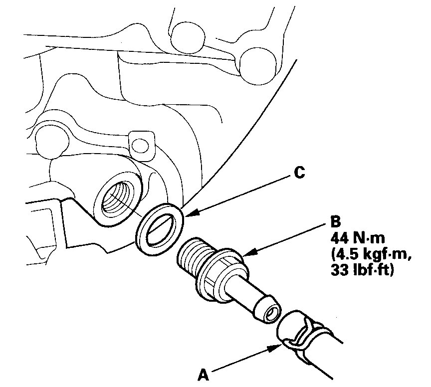

If you find there is a restriction and the hose is not kinked or plugged, here are the directions for replacing the PCV valve.
PCV Valve Replacement
1. Remove the intake manifold.
2. Disconnect the PCV hose (A).
pic 3
3. Remove the PCV valve (B).
4. Install the parts in the reverse order of removal with a new washer (C).
_____________________________________
Let me know what you find. Remember, a low idle can cause the lights to dim and a vacuum leak can cause the low idle. Therefore, I have a feeling the two are connected.
