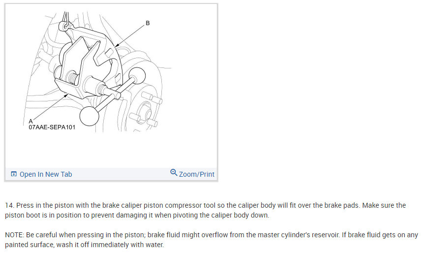

Okay so here's the situation. On my way out of the car I out some things down to get them all in my bag. I left the driveway and noticed the brakes were grinding

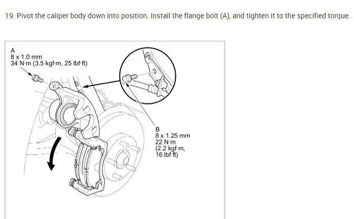

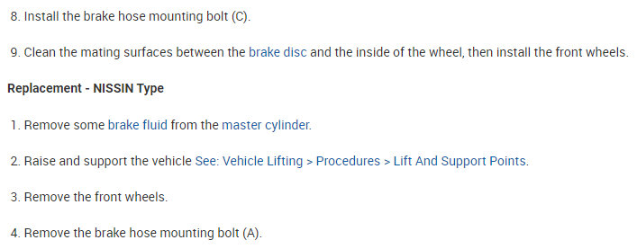

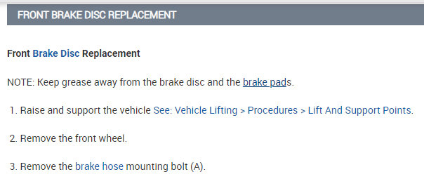

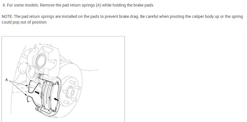

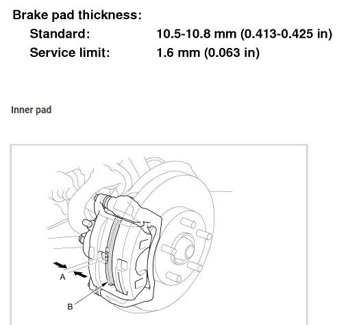

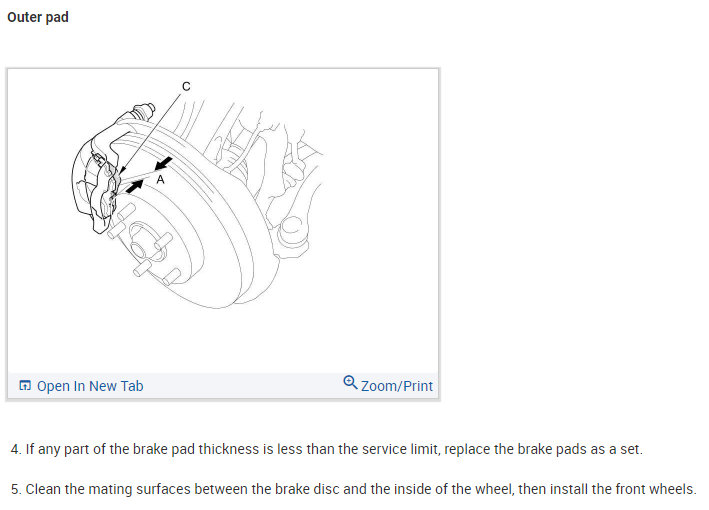

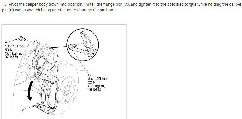

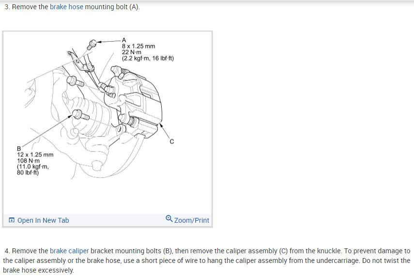

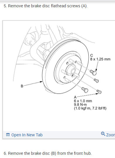

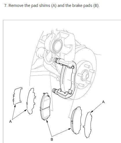

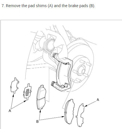

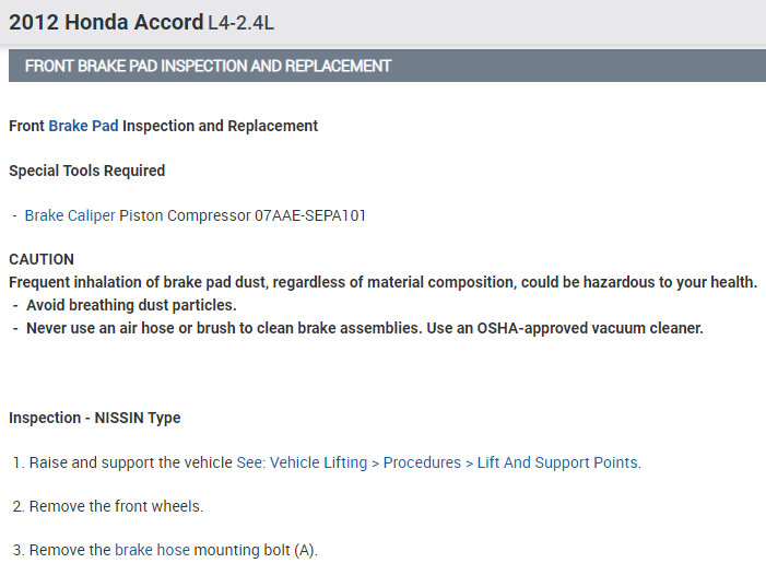

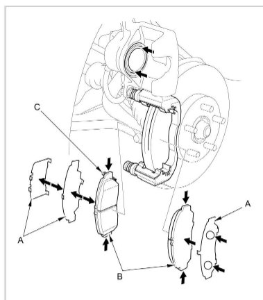

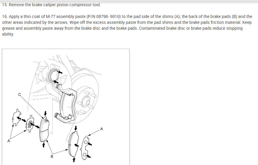

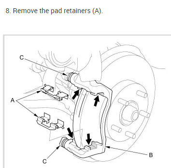

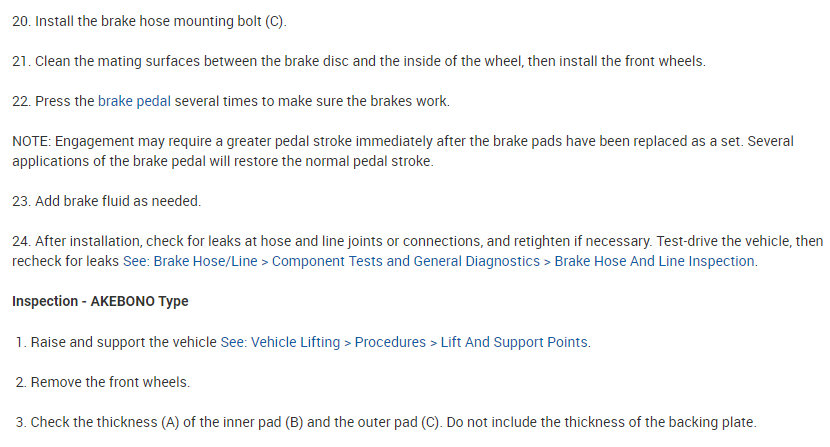

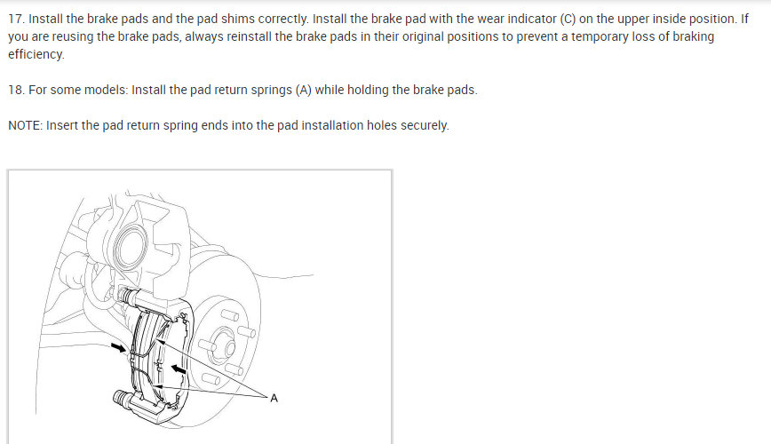

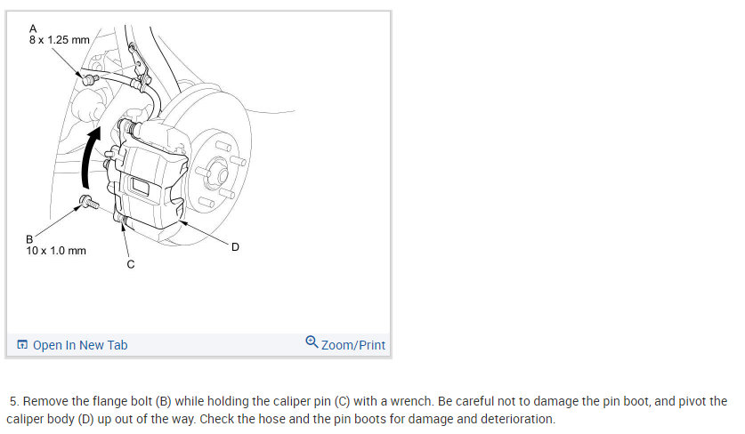

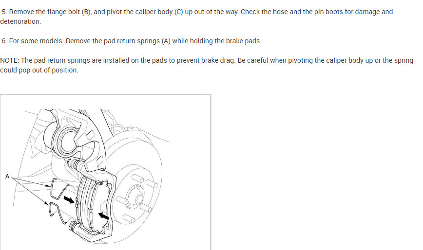

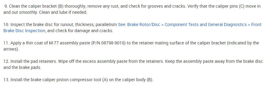

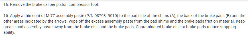

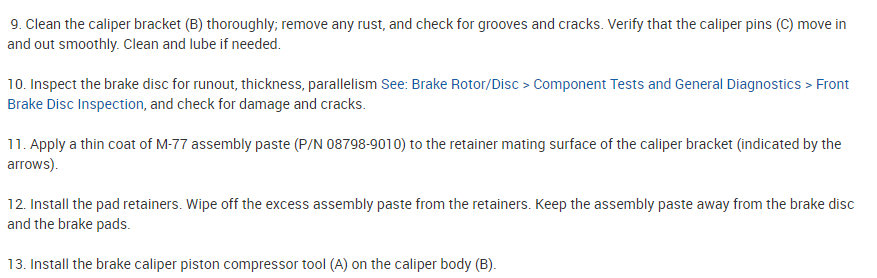

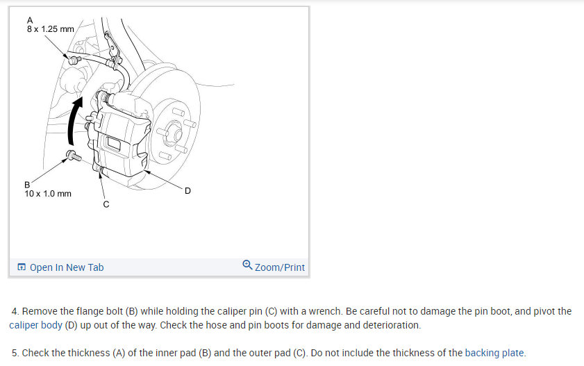

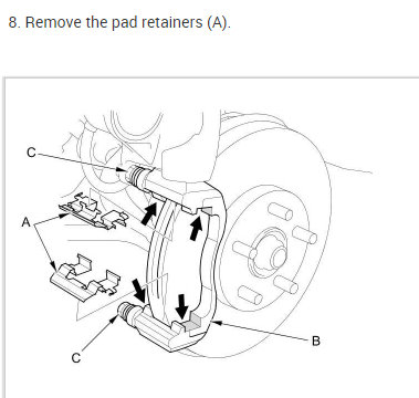

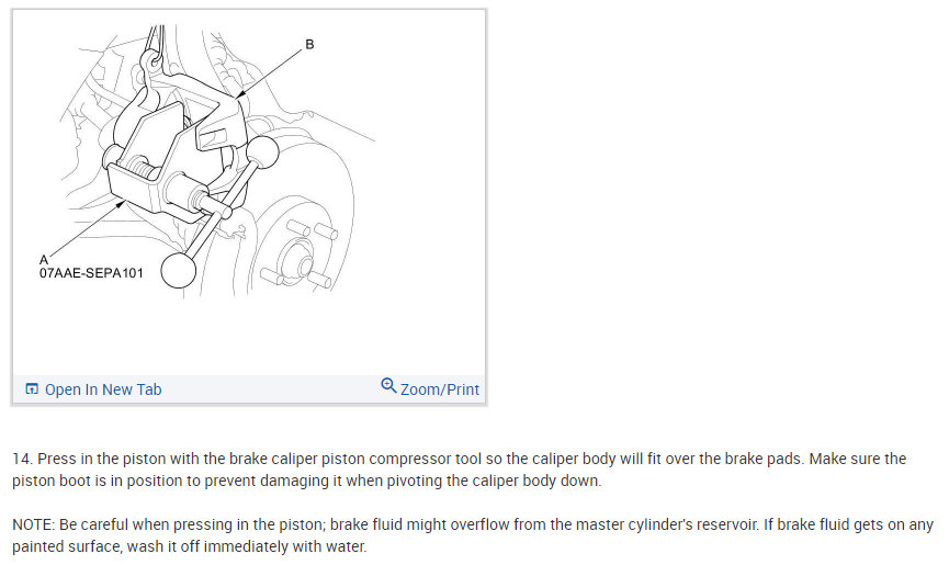

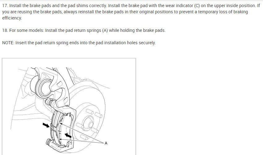

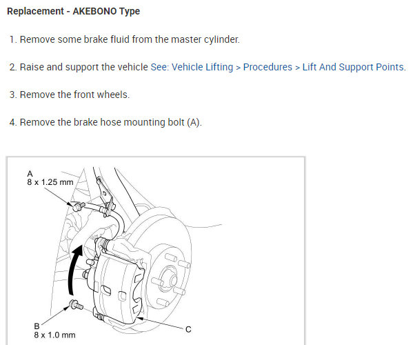

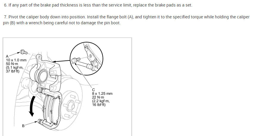

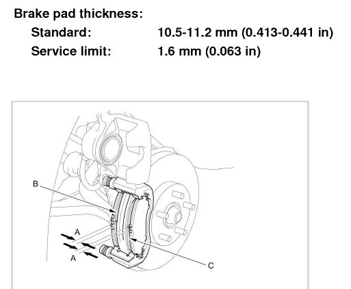

Here is the information you requested. This is a tutorial showing what is involved on how to change front brake pads and brake rotors:
I've attached picture steps below on how to change the front brake pads and rotors on your car. Hope this helps and thanks for using 2CarPros.
