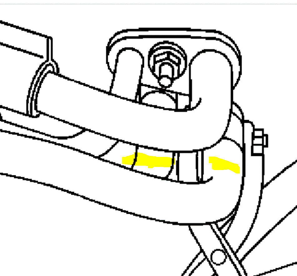

No heat. Over the last couple weeks, my mechanic:
- Replaced the blend-door
- Replaced the thermostat
- Replaced the heater core
- Burped the system, twice
There is minimal heat while idling. When driving, about 1/2 mile down the road, it starts blowing cold air.
The blower works. The climate controls switch from defrost to heater, blend, and vents .It blows cold air out of all of them.
Mechanic noticed the coolant was down quite a bit in a weeks time.
I live in rural Wisconsin. I nearly froze going to an appt Friday. Please help me! My mechanic said he needs to ponder over this for a few days.
I was researching on line. The problem most closely resembles a problem with the heater control valve. However, my mechanic says my car doesn’t have one.

When he had the blend door off, did he verify the door was actually moving back and forth?
Are both heater hoses hot to the touch with the engine at normal operating temperature.
He is correct, there is no heater control valve in your engine.
I would also, remove one of the hoses while running to see if there is flow to and from the core to be sure there is circulation.

Yep, sounds like a circulation issue.

The hoses may have debris inside causing the coolant to be restricted and no flow the proper amount of coolant. He needs to check all the way back to the intake manifold.

I hope you don't mind me jumping in. Roy is correct saying it is likely a circulation issue. Here is an easy way to check:
Start the vehicle and turn the heat on high. Allow the engine to run until it reaches operating temp. Then you can turn the engine off. Open the hood and feel both heater core hoses. Both should be hot (one may be slightly warmer simply because it is a supply line). If one is cool and one hot, there is a circulation issue.
The heater hoses are behind the engine and attach to the heater core. They are rubber hoses approximately 1" in diameter. See attached pic.
Also, let us know if the engine is reaching operating temperature.
Here are the bleeding directions. There is a bleeder on the thermostat housing. I'm not sure if that is what you are using.

I flushed the heater core I think that did it, thank you so much I have heat again!
Mar 22, 2021 at 12:53 PM
PATTY S
  • 5 POSTS
I guess I thought the system flush would have cleared the hoses.
