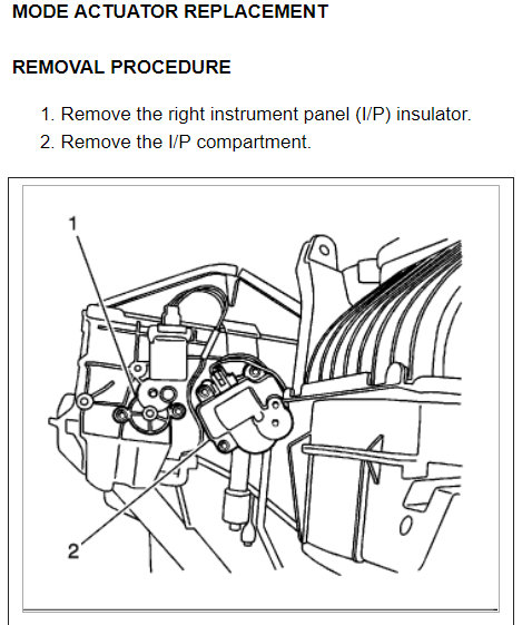

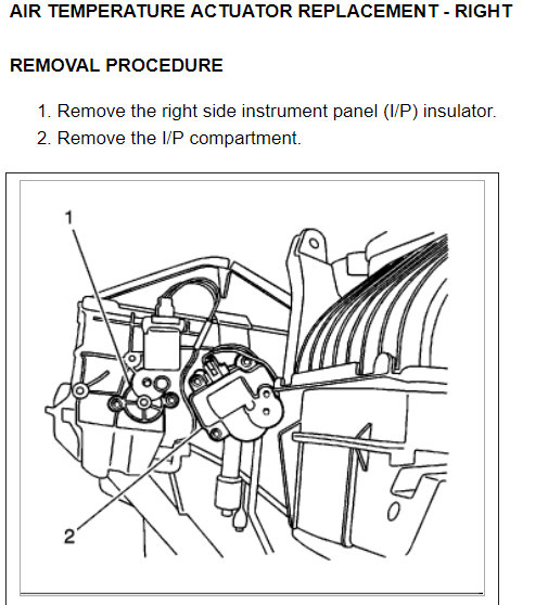

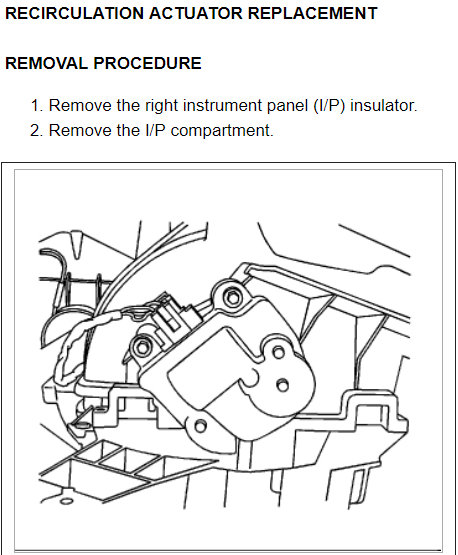

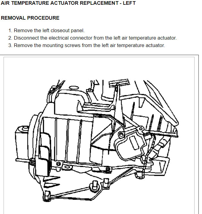

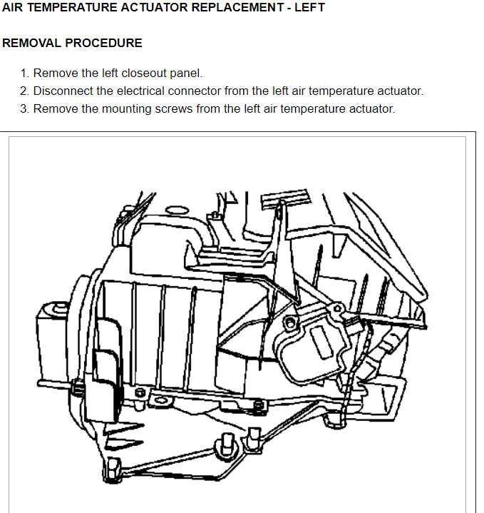

When I set Automatic on my Heather/Air Conditioner control I am not getting heat coming out of the vents. There was a noise being made in the off position which went away when I pushed the automatic button that is not there now. A fluttering noise of some kind.
Nov 1, 2010 at 5:15 AM
HMAC300
  • 48,601 POSTS
This sounds like you have low engine coolant or the temperature blend door actuator stopped working but to but sure this video and guide can help us fix it.
https://youtu.be/SNRb6pSwYuU
and if the temperature blend door needs replacement here is a guide that can help with diagrams below to show you on your car.
This guide can help as well
Check out the diagrams (Below). Let us know what happens and please upload pictures or videos of the problem.
