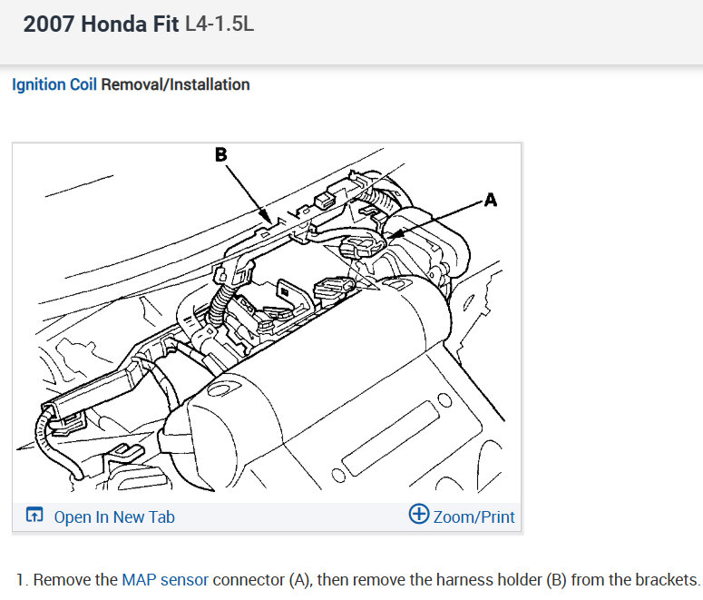

Starts and idles fine, but once I give it about 15%+ throttle it starts to bog down, then the check engine light flashes for a few seconds.
Where do I start?

This sounds like a simple engine misfire; I would run the codes to see which ones are stored. Also, if the engine has not been tuned up, I would start there.
Here are guides to help us get started on fixing the problem:
This guide gives you information on the engine misfire:

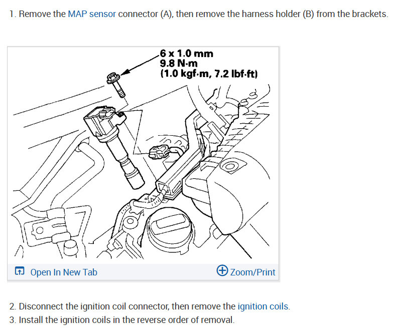

Let's do the tune up and I have included information for your car to help. I would also service the throttle body.
https://www.2carpros.com/articles/how-to-tune-up-a-car-engine
Spark Plugs
NGK: .................... IZFR6K13
DENSO: .................... SKJ20DR-M13
I would install new ignition coils as well, also a very common failure. Check out the images (below). Let us know how it goes.
