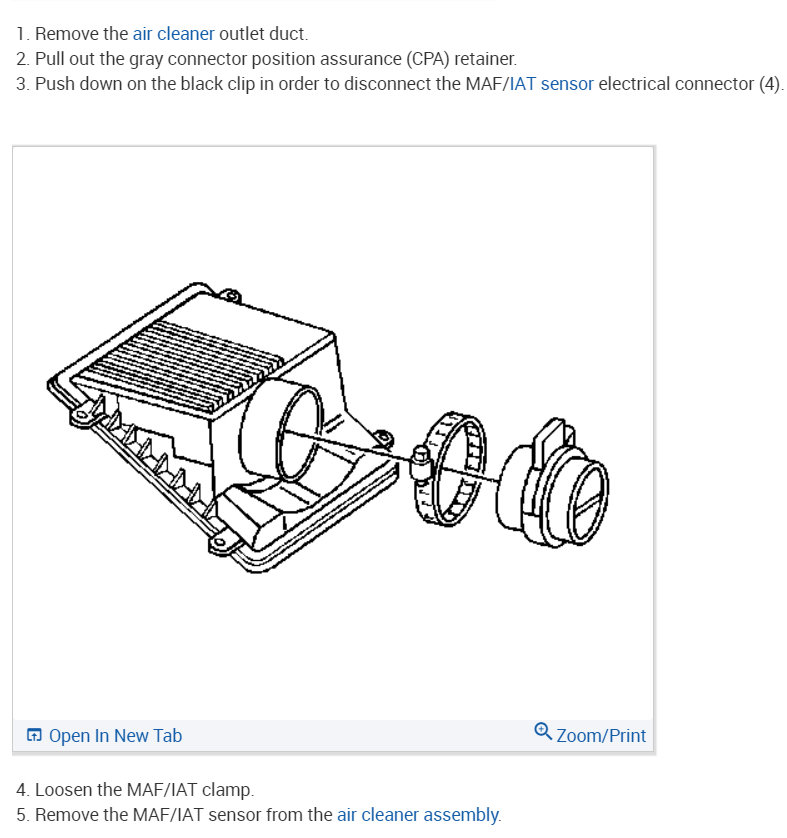

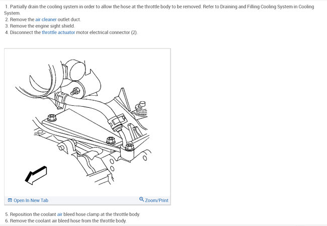

when cold vehicle stumbles at start and then idles normal, also when idling has a small miss. no codes at all or showing. checked fuel pressure when vehicle is off 50 PSI some loss of power when truck is under load.
Sep 27, 2022 at 1:01 AM
  • 55,588 POSTS

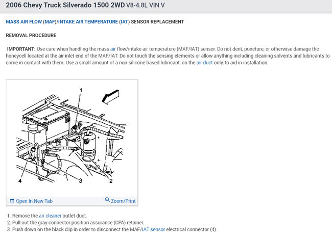

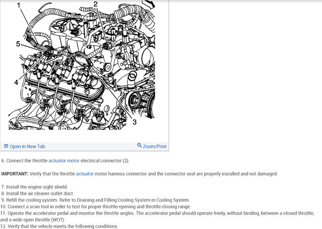

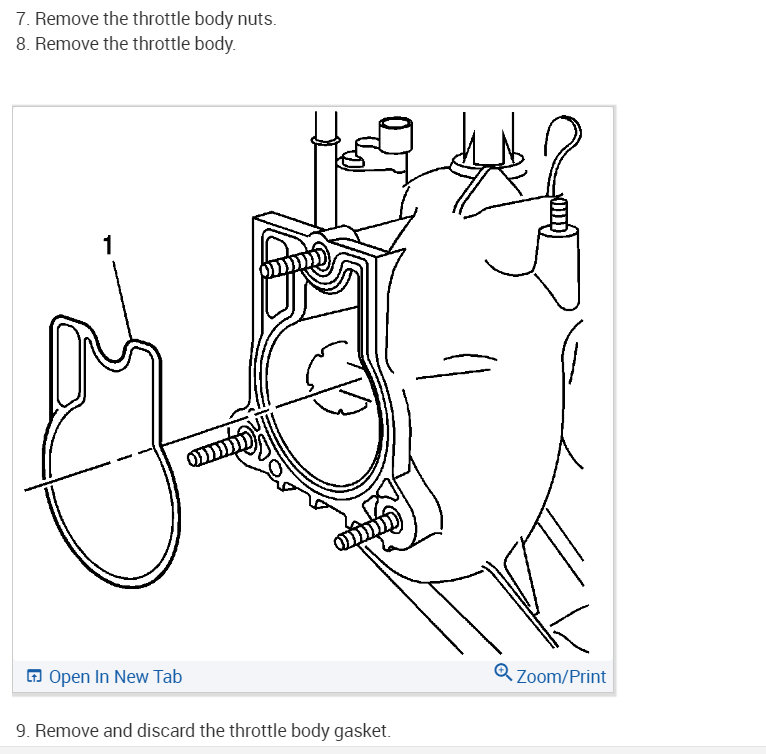

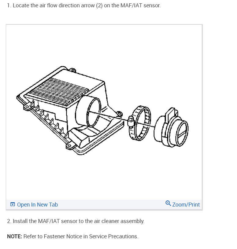

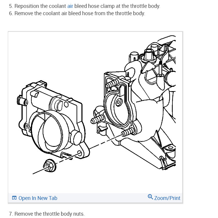

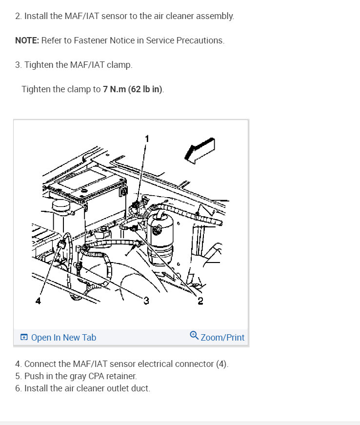

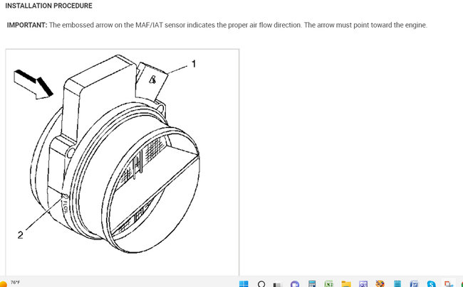

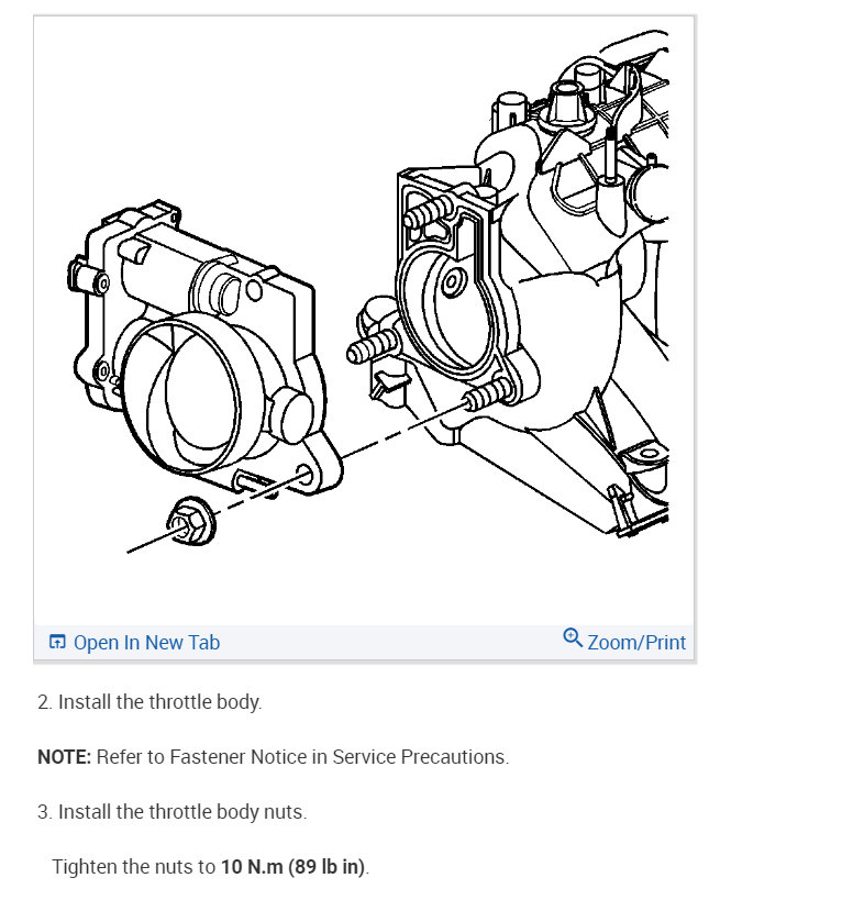

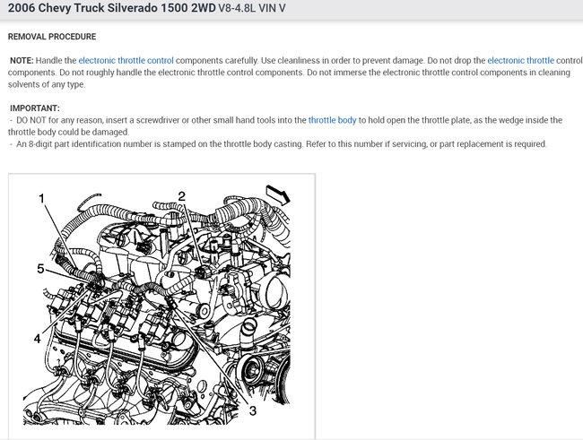

The fuel pressure sounds okay, I would say the MAF sensor needs to be replaced which is common on these trucks with many miles. also, I would clean the throttle bore, here is a generic guide on how to replace the sensor and instructions below to show you how on your truck. I have included a video on how to service the throttle bore.
https://www.2carpros.com/articles/how-to-replace-a-mass-air-flow-sensor-maf
and
https://youtu.be/Z3LDHdS1upo

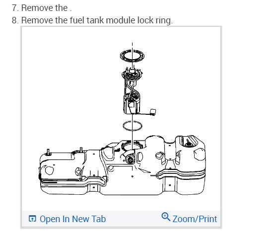

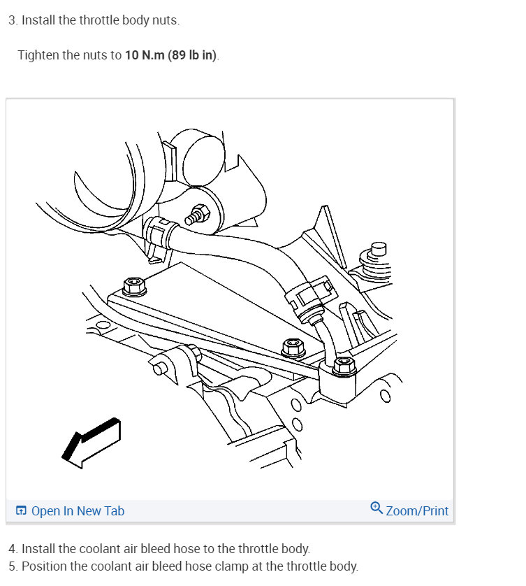

Okay, replaced MAF and cleaned throttle bore, no change. checked the fuel pressure again at the rail no getting 42 PSI. still thinking maybe, a weak fuel pump. any thoughts?
Sep 28, 2022 at 7:13 AM
  • 55,588 POSTS
Yep, the fuel pressure is low.
Fuel Pressure (Key ON, Engine OFF) .................... 385-425 kPa (55-62 psi)

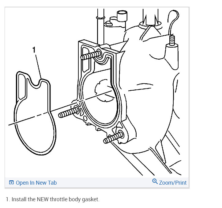

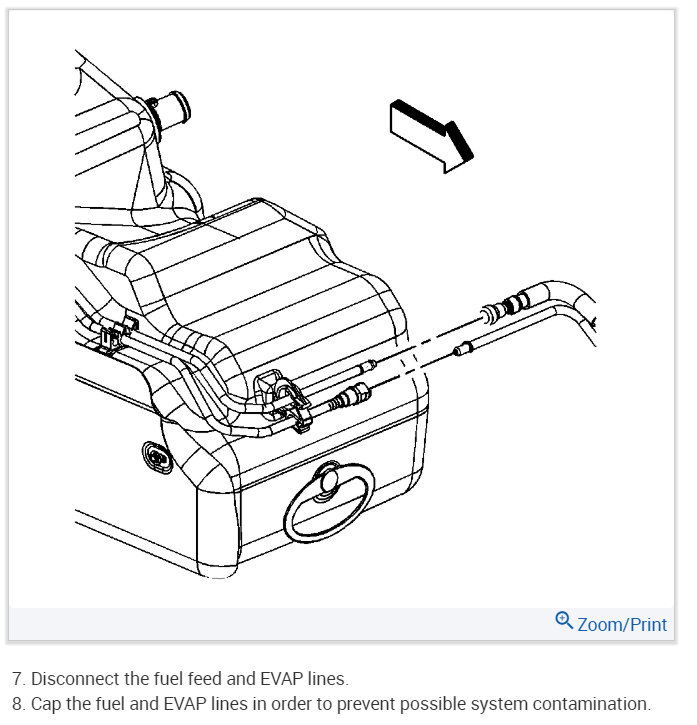

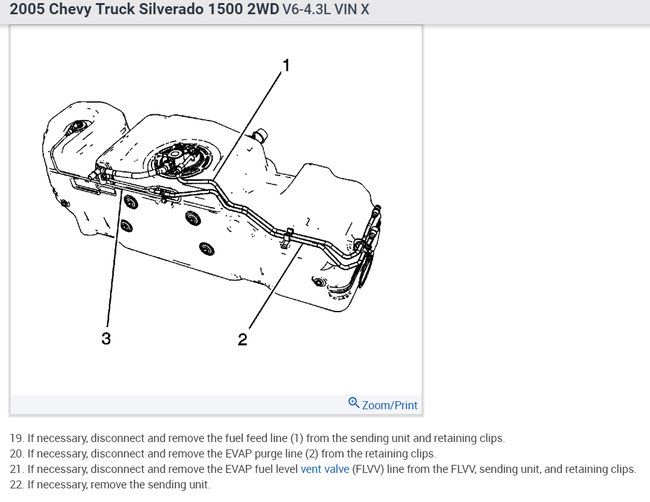

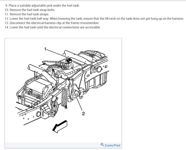

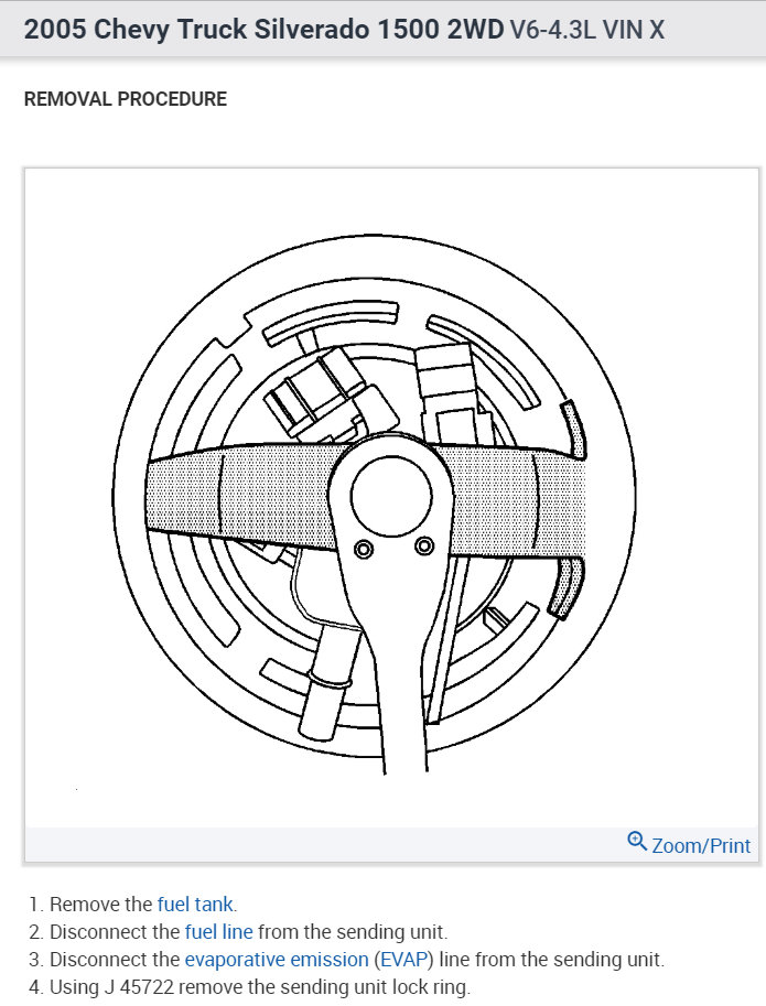

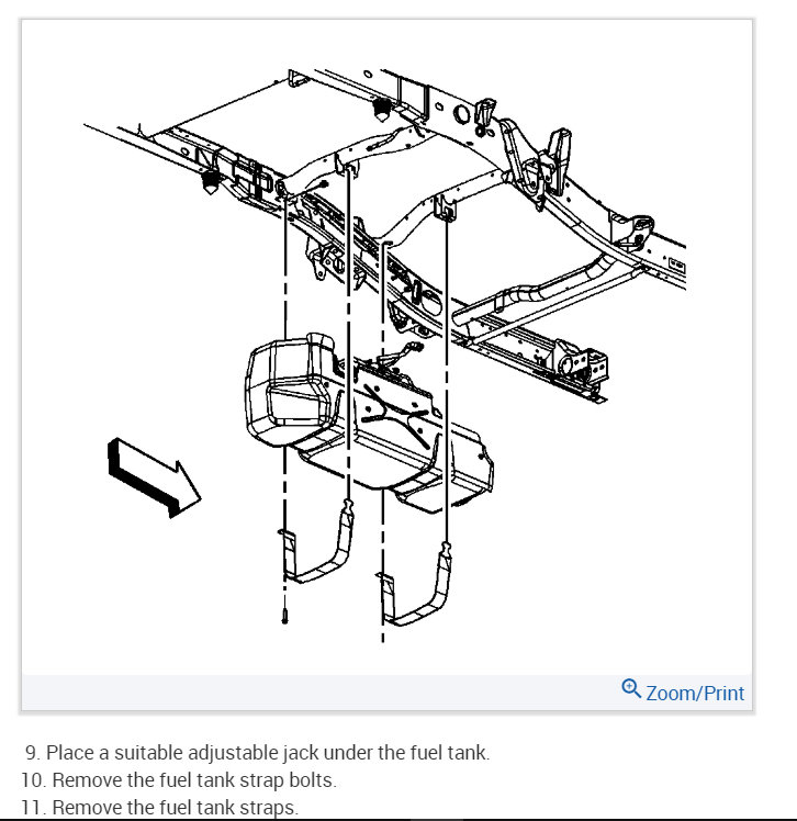

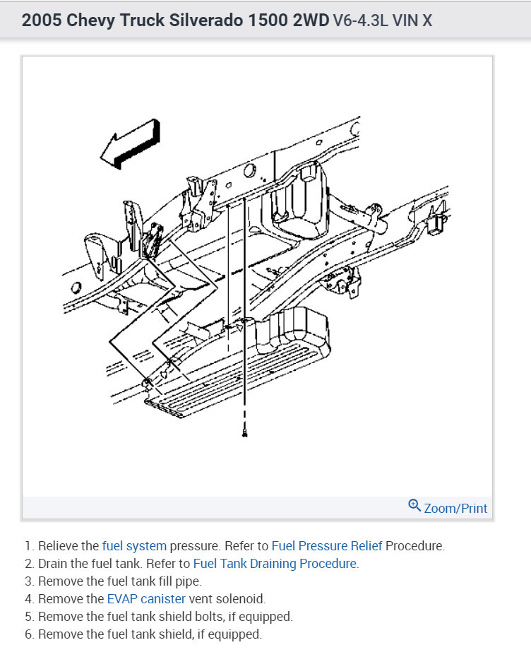

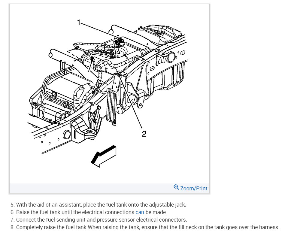

I would install an AC Delco fuel pump here are the instructions on how to do the job in the images below. Check out the images (below). Please let us know what happens.
Sep 29, 2022 at 6:01 AM
JS69862000
  • 5 POSTS
Replaced fuel pump and still having issues with cold start and miss.
