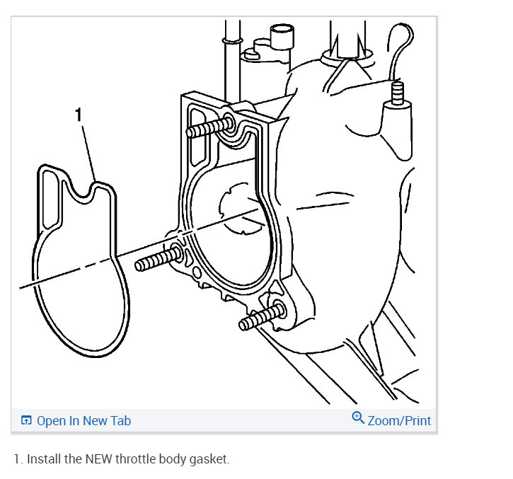

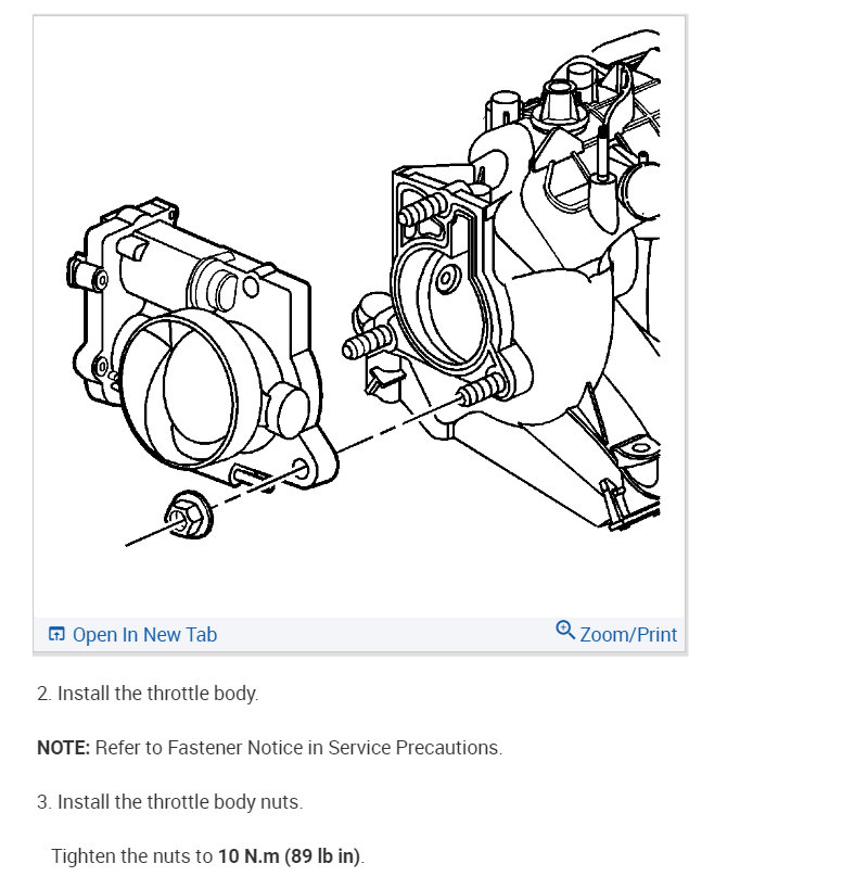

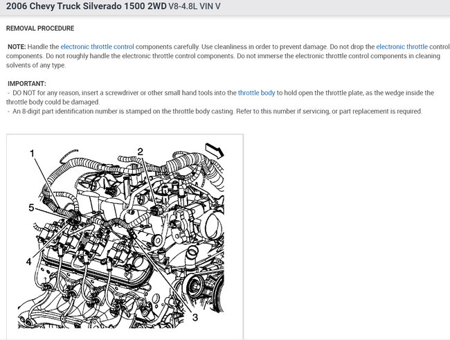

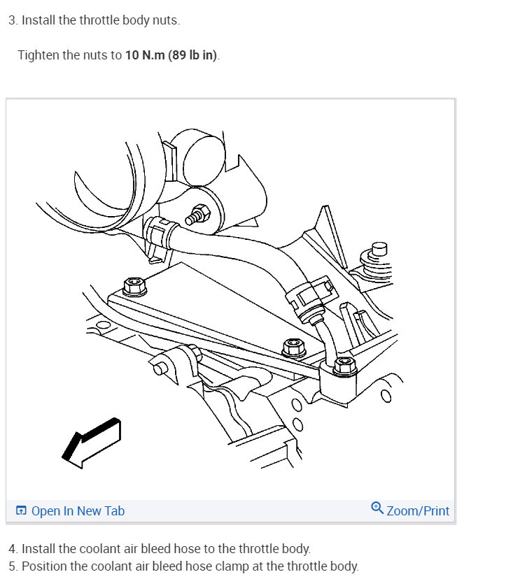

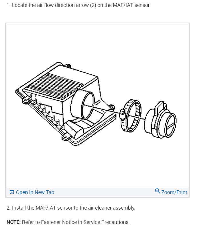

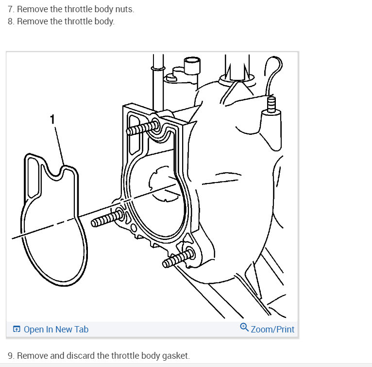

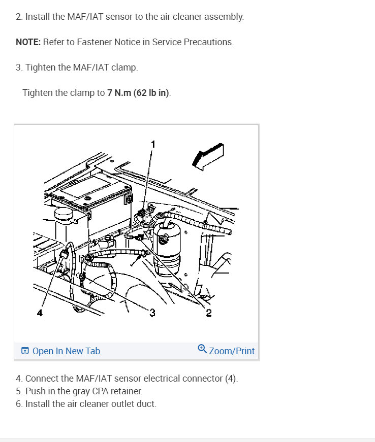

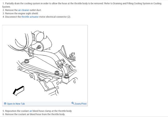

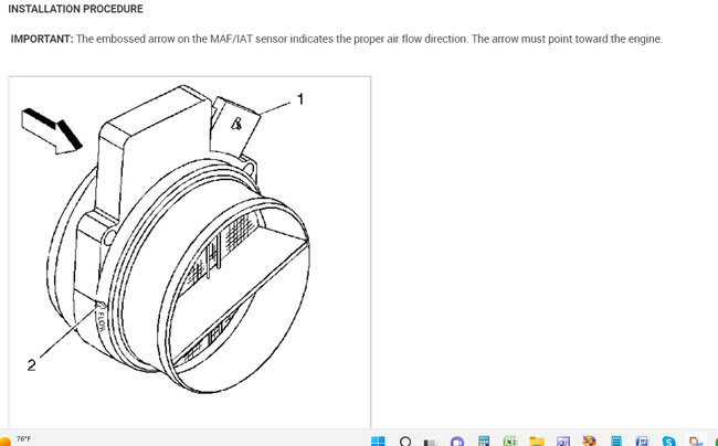

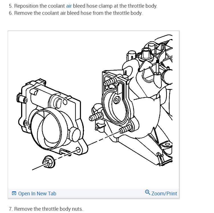

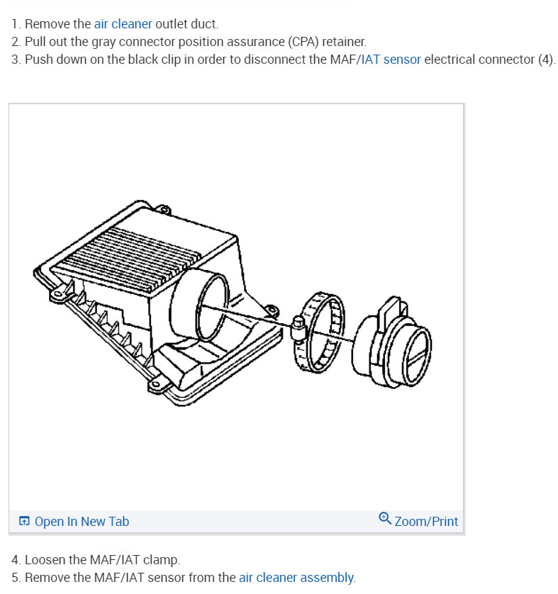

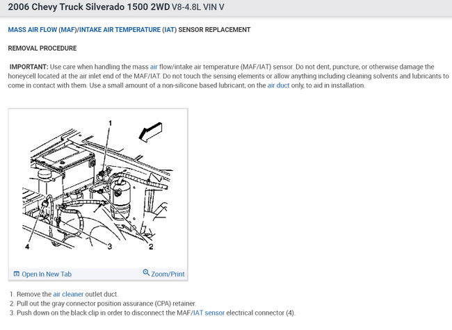

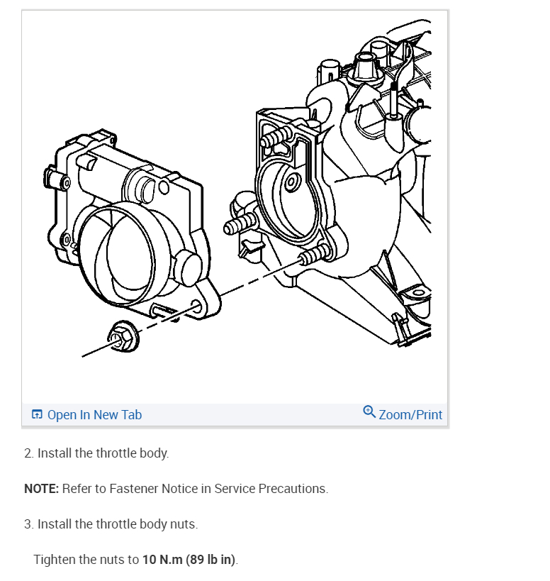

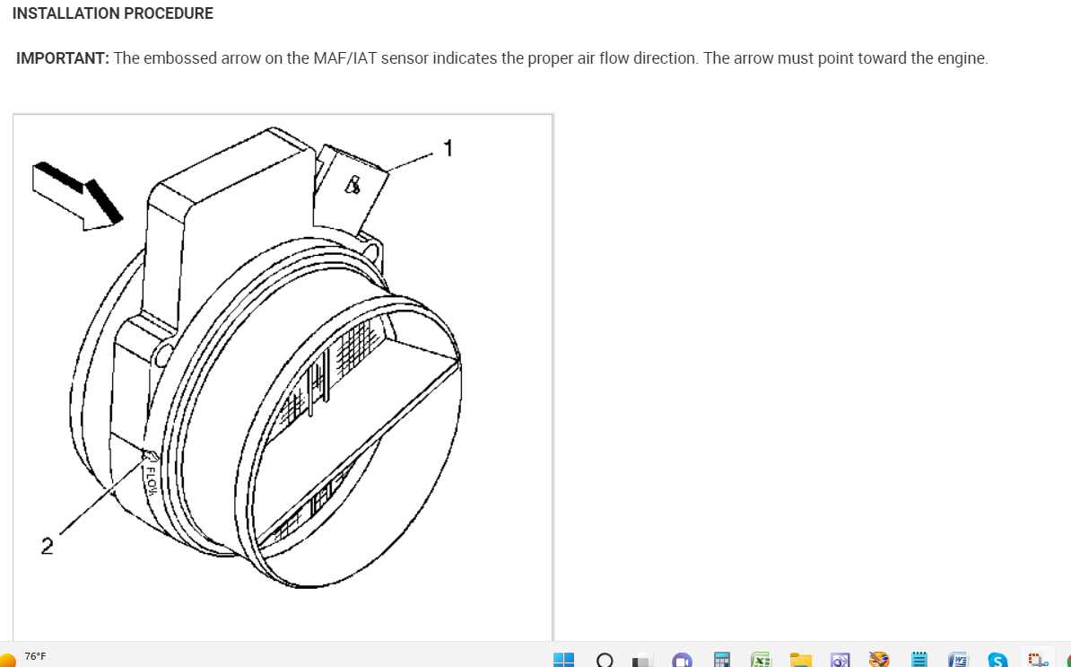

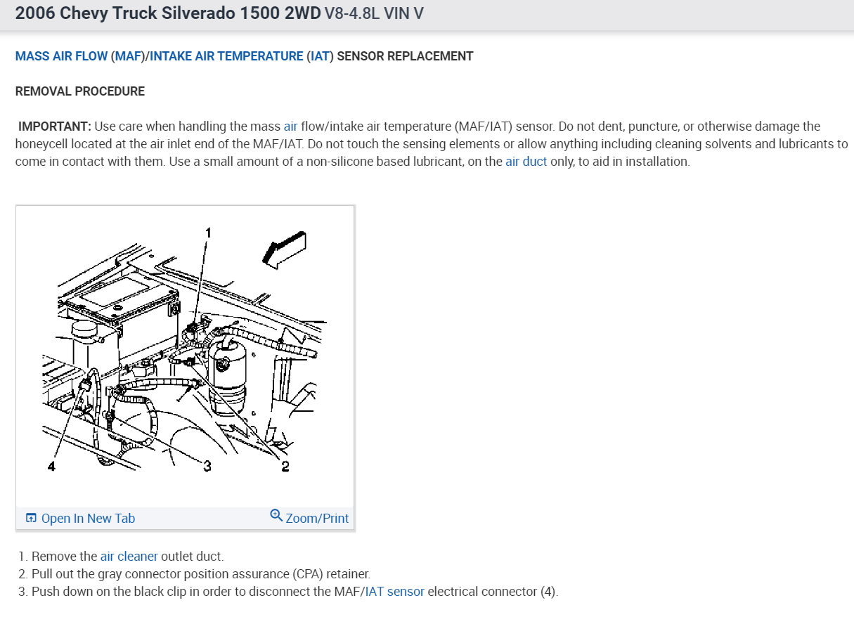

The fuel pressure sounds okay, I would say the MAF sensor needs to be replaced which is common on these trucks with many miles. also, I would clean the throttle bore, here is a generic guide on how to replace the sensor and instructions below to show you how on your truck. I have included a video on how to service the throttle bore.
https://www.2carpros.com/articles/how-to-replace-a-mass-air-flow-sensor-maf
and
https://youtu.be/Z3LDHdS1upo

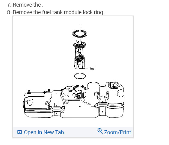

Yep, the fuel pressure is low.
Fuel Pressure (Key ON, Engine OFF) .................... 385-425 kPa (55-62 psi)

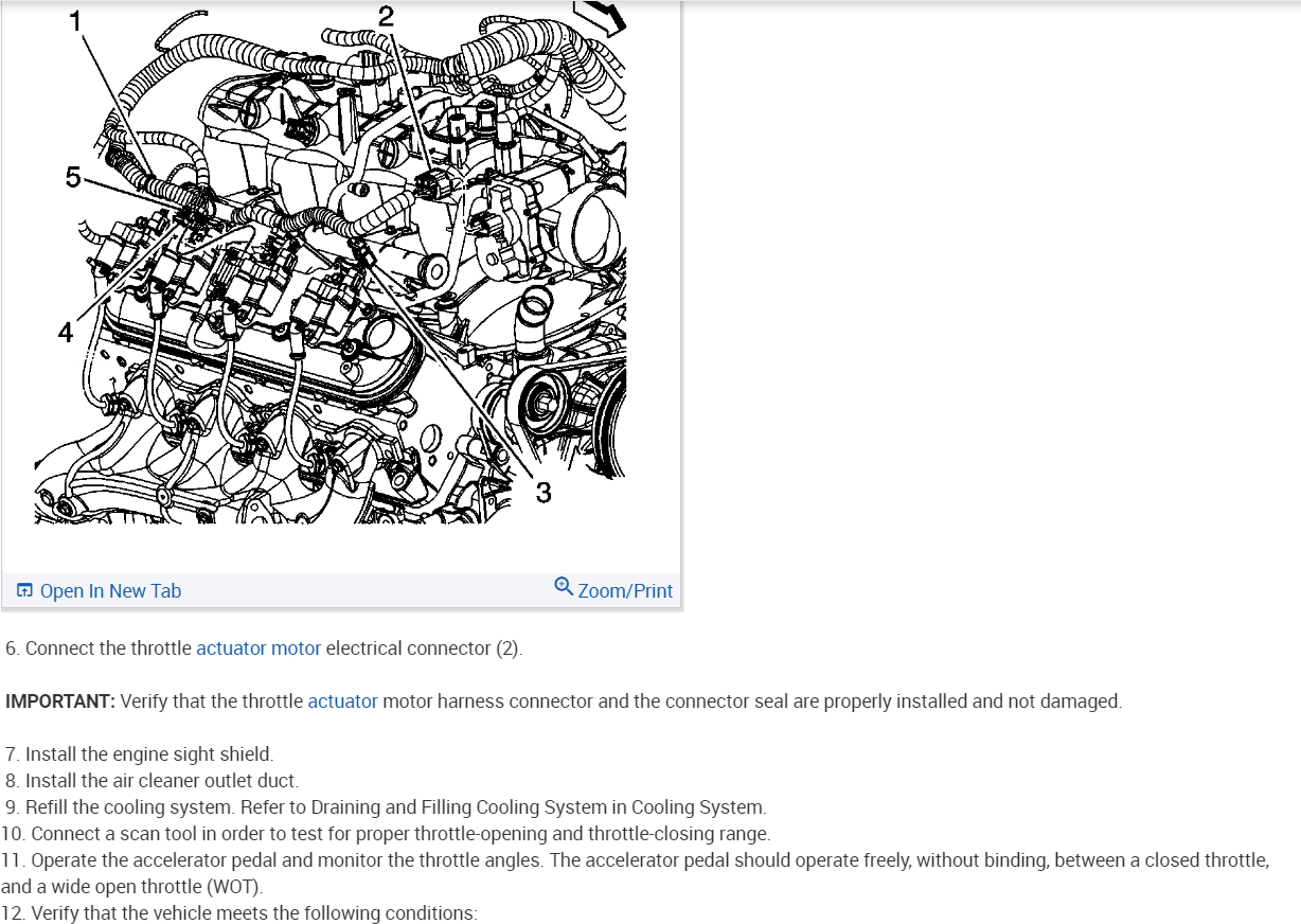

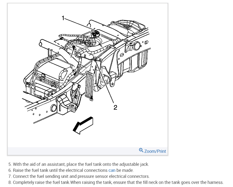

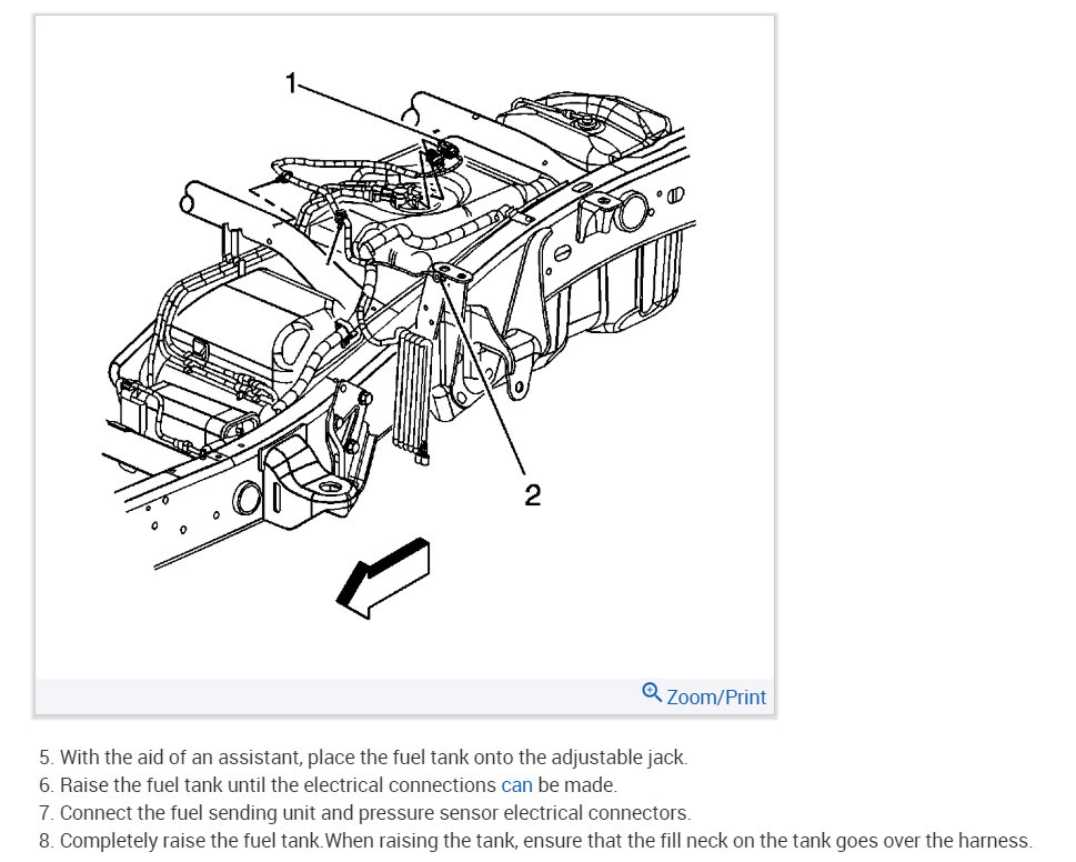

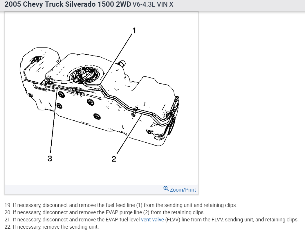

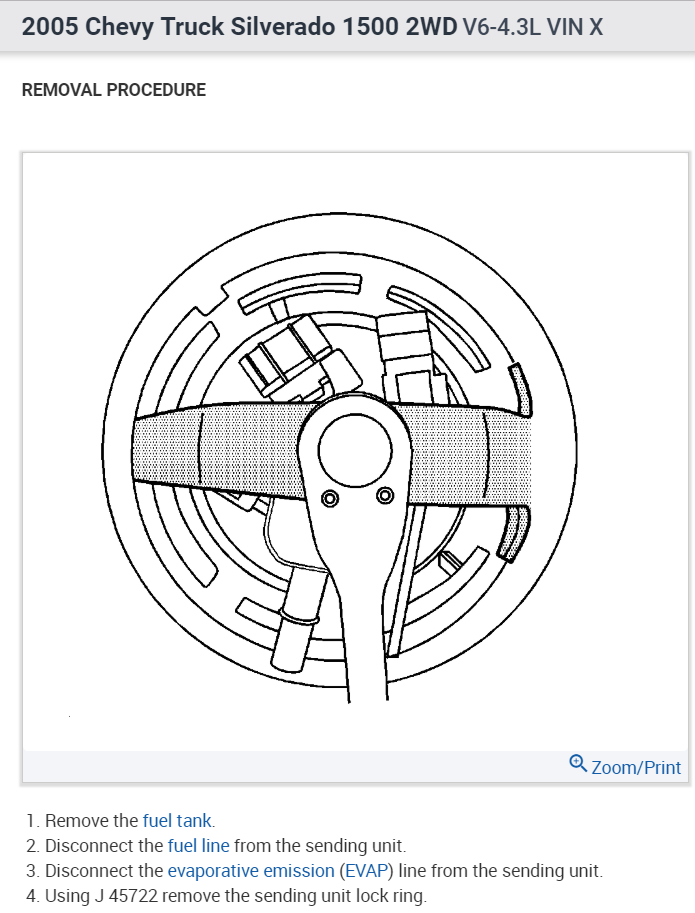

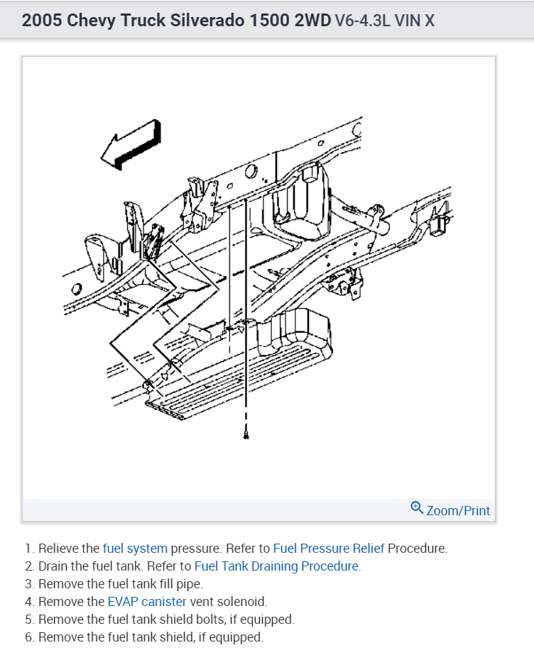

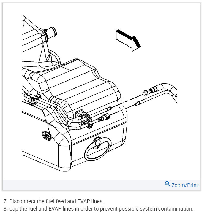

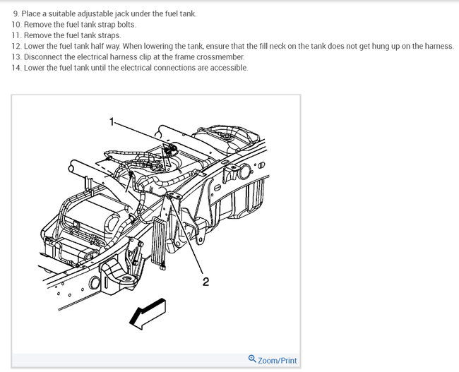

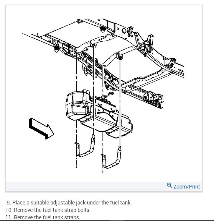

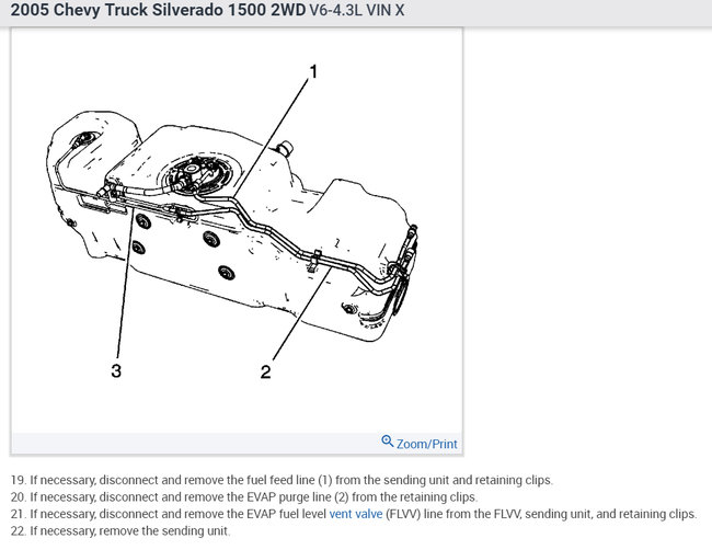

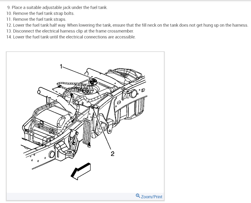

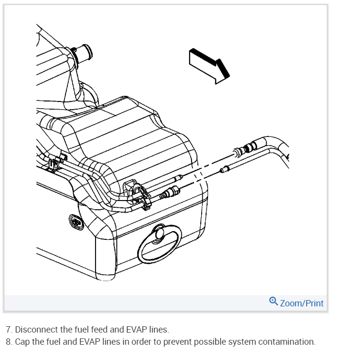

I would install an AC Delco fuel pump here are the instructions on how to do the job in the images below. Check out the images (below). Please let us know what happens.
