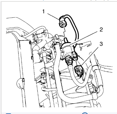

When start up it stumble at start up. Code P0171 and P0496. Cleaned and replaced the maf sensor, checked vacuum leaks. Not it evap purge value stuck open.

The P0496 code along with the startup stumble makes the EVAP canister purge valve a good place to start testing.

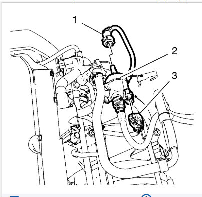

With the purge valve electrically disconnected and the engine off, the valve should be closed and should not allow airflow through it. If you can blow or draw air through the valve when it is not energized, the valve is leaking and should be replaced. Here is the location of the valve so we can be on the same page. Also, I would do a smoke test, this video will help.
https://www.youtube.com/watch?v=LRKWV4Are5c&t=3s&pp=0gcJCf4LAYcqIYzv
also, please go over this guide as well
https://2carpros.com/articles/repair-lean-mixture-codes-p0171-or-p0174-on-some-manufacturers/
Let me know what you find.

Thanks for your advice. I did find out i had a open evap purge valve causing the issue.
