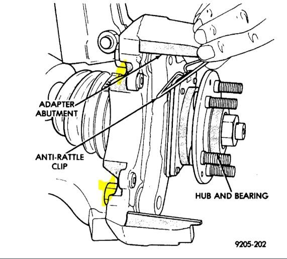

Hello. I'm trying to change a rotor but two studs snapped in half and got stuck. I have tried getting them out but can't figure it out. Is there anyway to get them off without removing the whole strut? I've tried pounding them out with a sledge, using a ratchet, and nothing budges. Please help.

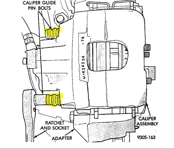

Are you referring to the caliper slide bolts or the caliper mount/adapter bolts? I attached two pictures. Tell me which picture is the one that shows the problem area. Also, if you take a look through this following link, it may better help you identify the part.

They are stuck in the hub and bearing.

Okay, then the caliper mount bolts broke in the steering knuckle (picture 1). The only way you are going to get them out is via a drill and an easy out. They are threaded into the steering knuckle. If the threads are damaged when you try to remove them, you have a couple choices such as a helicoil, retap the threads and replace the bolts, or replace the knuckle.
