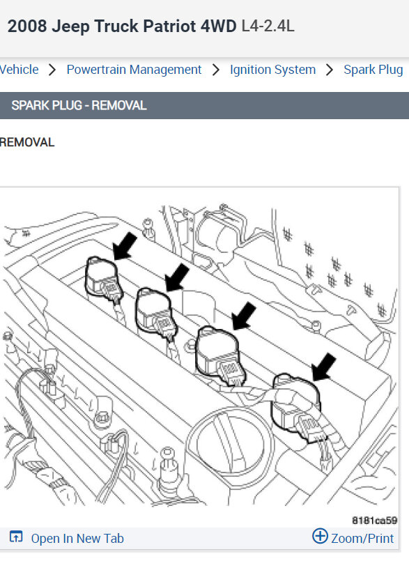

Stutters upon acceleration check engine light comes on for a week or so, then goes off.
Aug 28, 2024 at 1:21 AM
  • 55,399 POSTS

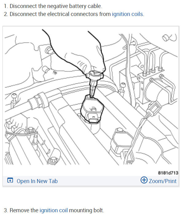

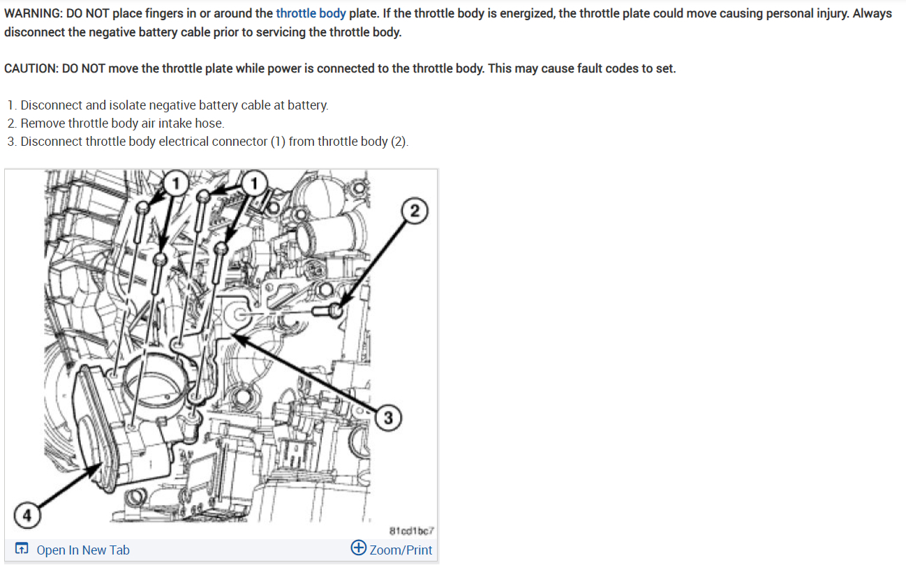

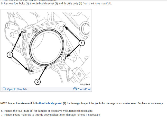

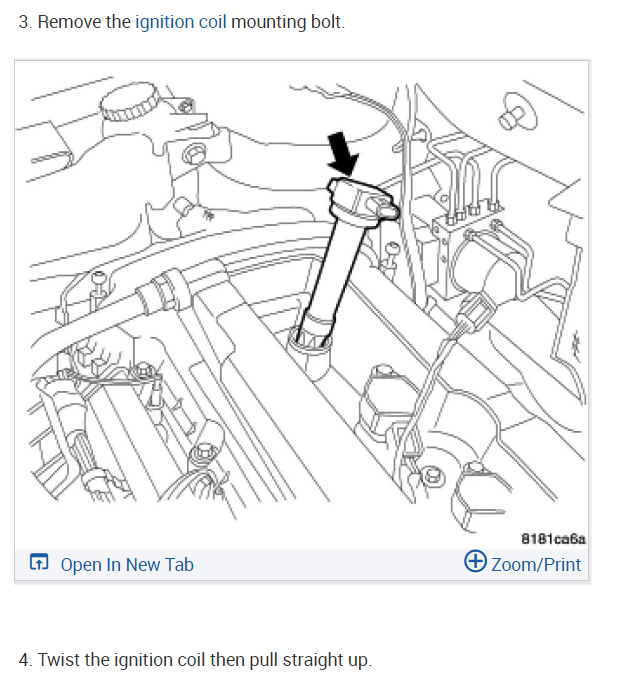

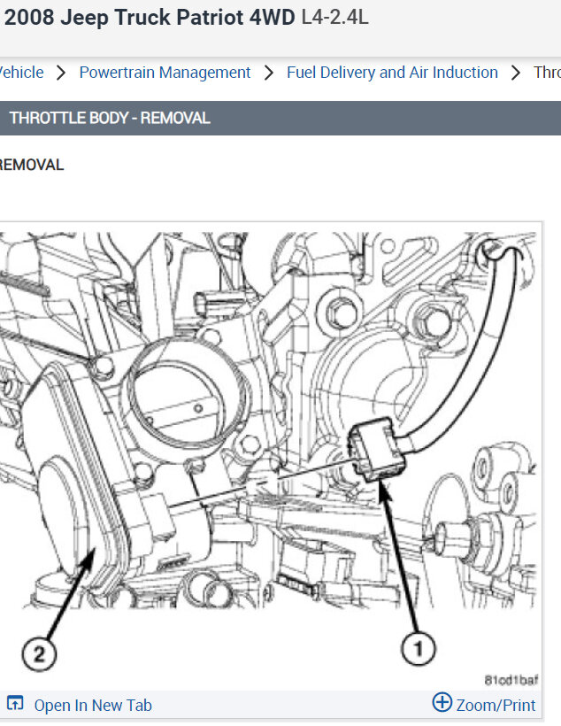

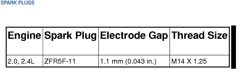

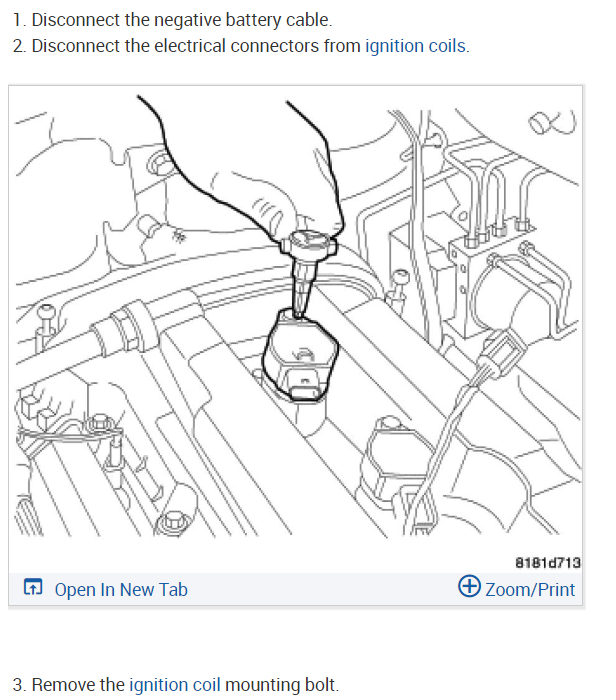

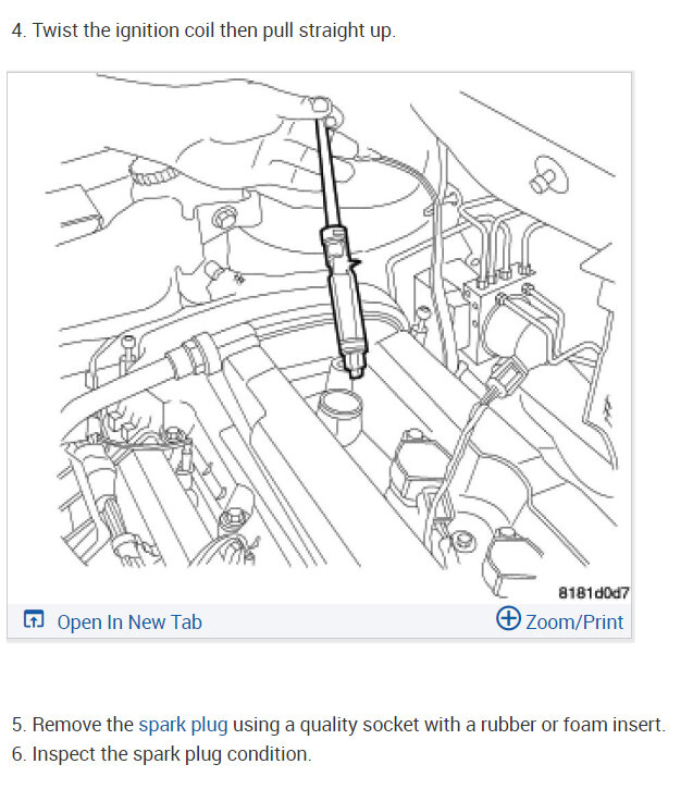

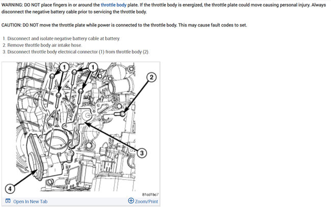

Yep, this is common when the engine is misfiring, I would do a full tune up with spark plugs, ignition coils and a throttle body service. You can run the codes to confirm the engine misfire code which will warrant the tune up as well.
This guide can help:
Install each spark plug to the cylinder head. Tighten spark plugs to 27 Nm (20 ft. lbs.).
If confirmed please follow this guide and I have included instructions for your car in the image below.
https://www.2carpros.com/articles/how-to-tune-up-a-car-engine
