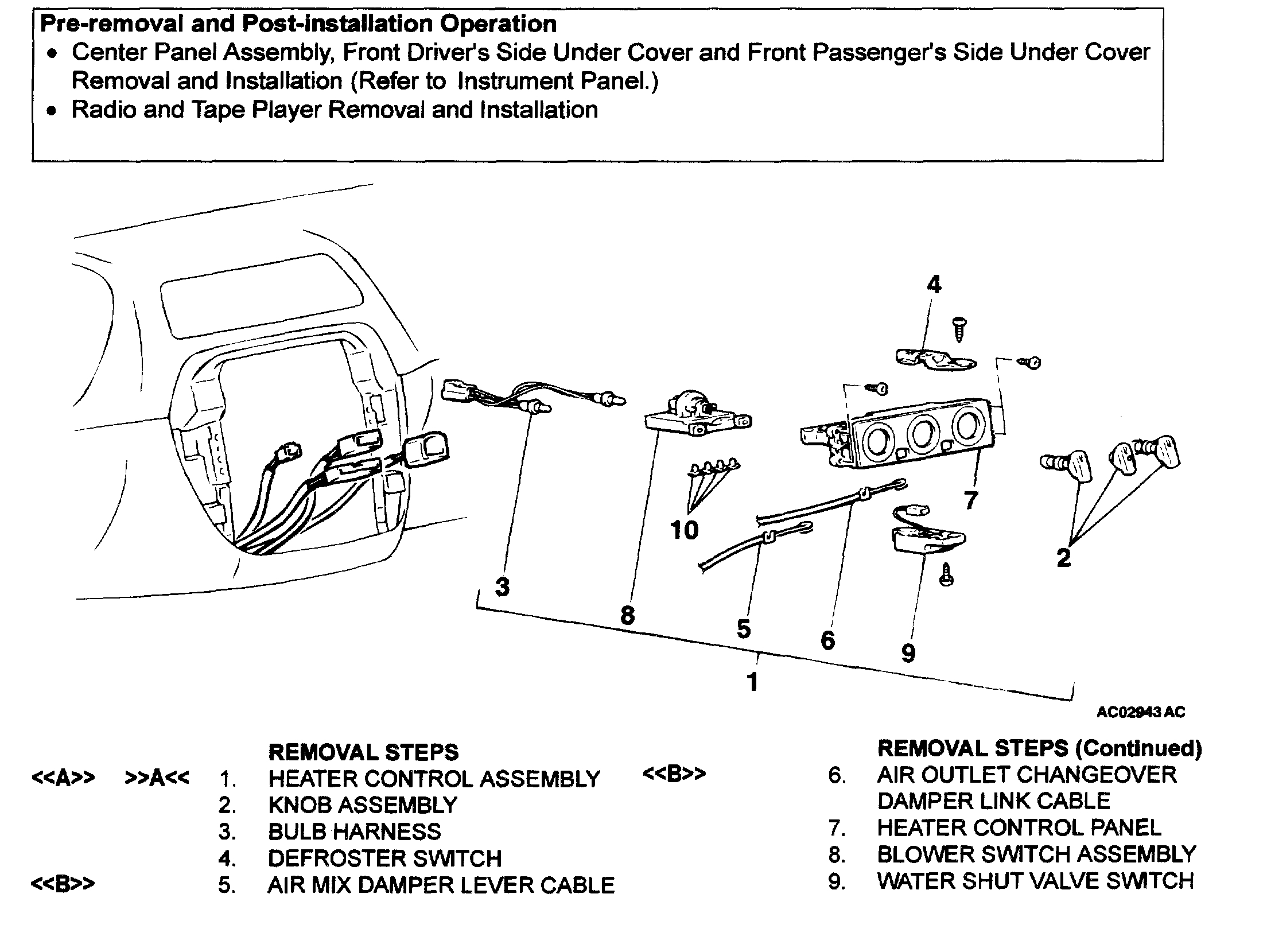

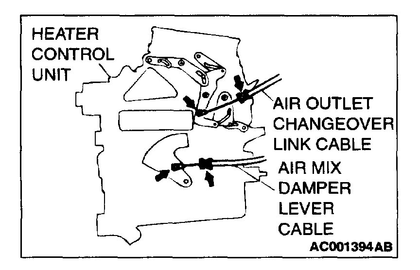

Chances are it is one of the things you mentioned. Here are all the directions for cables and the system. I attached all pictures related to the different procedures. For some reason, the directions are all lumped together for this vehicle.
HEATER CONTROL ASSEMBLY AND A/C SWITCH
REMOVAL SERVICE POINTS
HEATER CONTROL ASSEMBLY REMOVAL
After disconnecting the heater/cooler unit side connections of the air mix damper lever cable and air outlet changeover link cable, remove the heater control assembly.

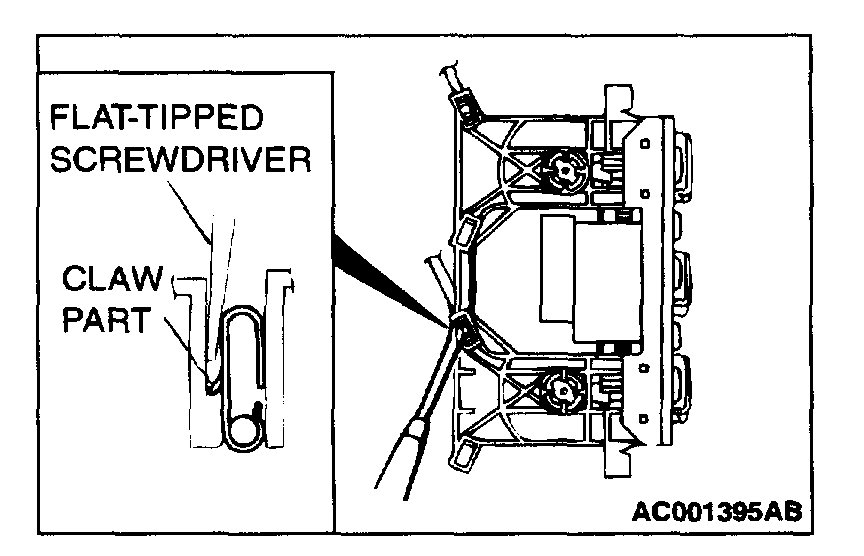

AIR MIX DAMPER LEVER CABLE, AIR OUTLET CHANGEOVER DAMPER LINK CABLE REMOVAL
Insert a flat-tipped screwdriver into the control base clip from inner side, and then remove the cable by lifting the claw part of the clip.

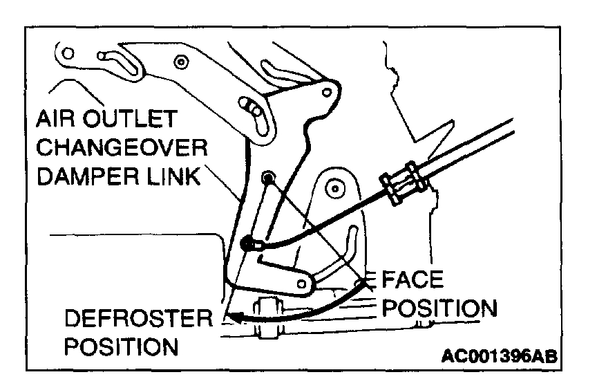

1. Follow the steps below to install the air outlet changeover damper link cable.
1. Set the air outlet changeover control knob on the heater control assembly to the defroster position.
2. Set the air outlet changeover damper link of the heater/cooler unit to the defroster position as shown in the illustration, and then connect the cable to the link pin.
3. Push the outer cable in the direction so that there is no looseness, and then secure it with the clip.

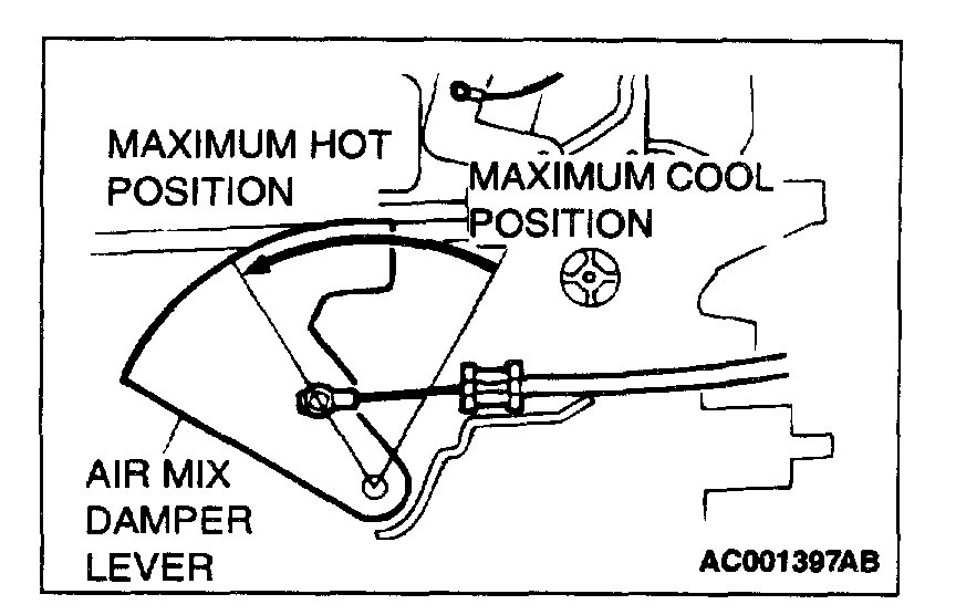

2. Follow the steps below to install the air mix damper lever cable.
1. Set the temperature control knob on the heater control assembly to the maximum hot position.
2. Set the air mix damper lever of the heater/cooler unit to the maximum hot position as shown in the illustration, and then connect the cable to the lever pin.
3. After installation, ensure that each damper operates smoothly by operating the heater control assembly knob.

Thank you for your input. I was able to fix the issue and it was neither the cable nor the heater core. I had to spend some time removing the paneling beneath the steering wheel and removed the foot vent down there but then i had clear access to the mechanism in the pictures. One of the plastic parts of the mechanism was jammed for some reason and I was able to figure out which and simply disconnected it which allowed the knob to move freely and everything works. It was the white piece with a zigzag cutout in the middle of it, it is in the fourth picture but is covered by the words "face position". not sure why it was jammed and refused to move but am happy with the results and saved a massive amount of money.
