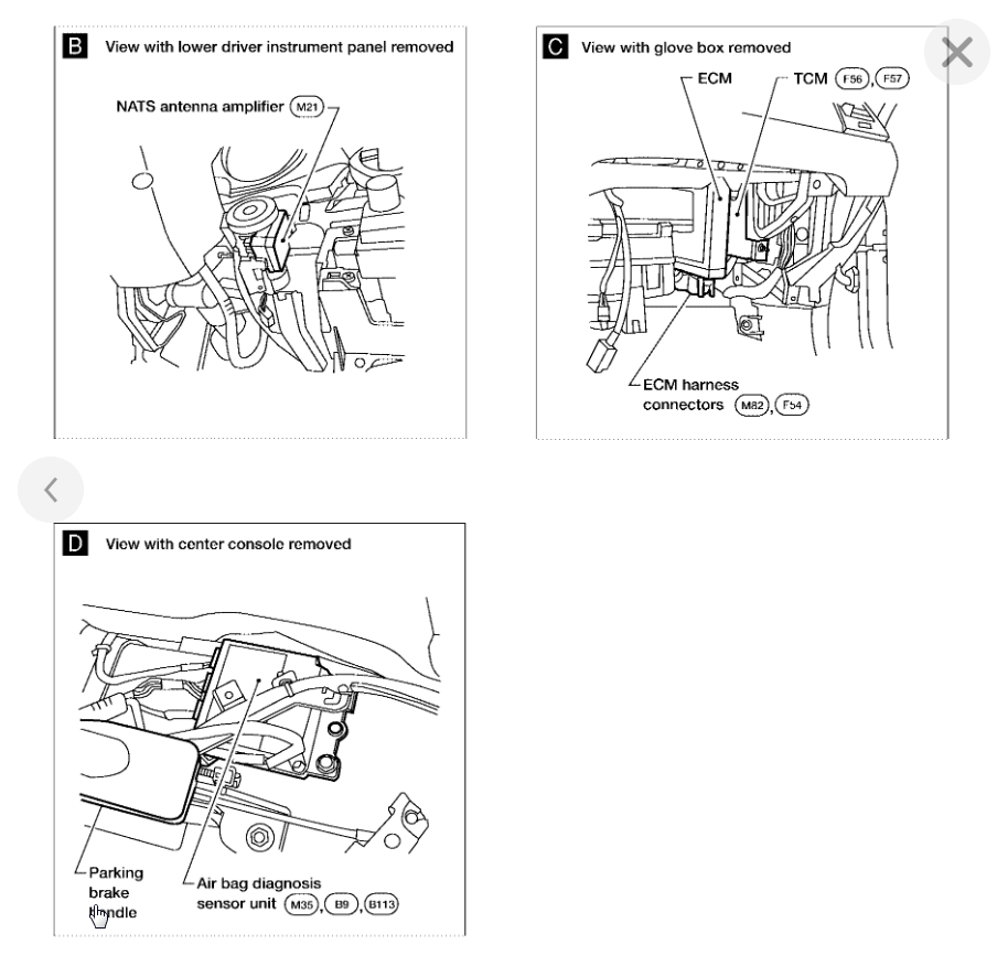

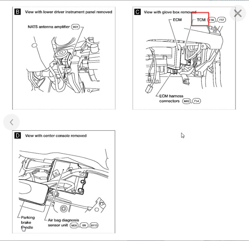

I disconnected the battery and then unplugged the ECM harness from the unit. where is the TCM located and the procedure to reset it? thanks
Mar 6, 2020 at 9:28 AM
See the attached. It should be right next to the ECM in the glove box. There is not official way to reset it without a scan tool. The easiest way to reset all the models is to disconnect the battery and touch the cables together off the battery. Then leave them off for about 10 minutes and that will be like a hard reset that you would do on your phone. It will force the modules to reboot.
