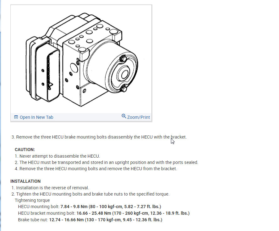

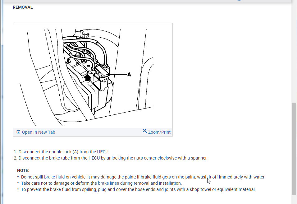

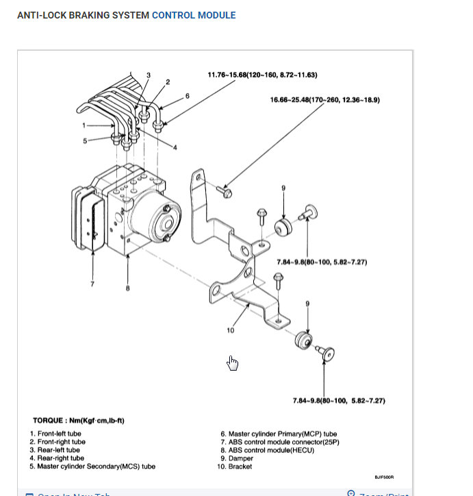

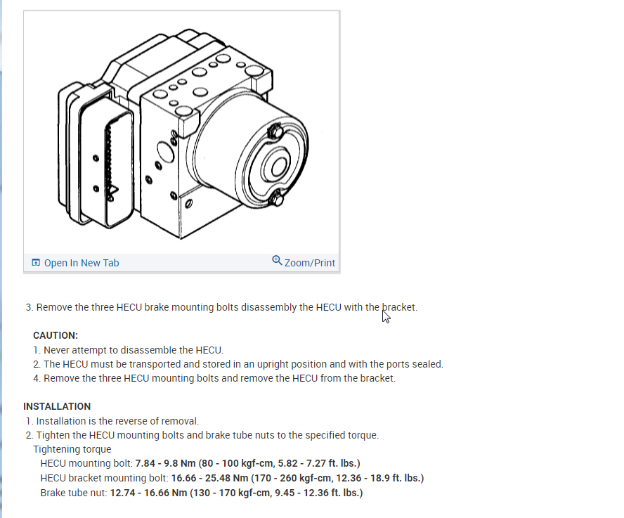

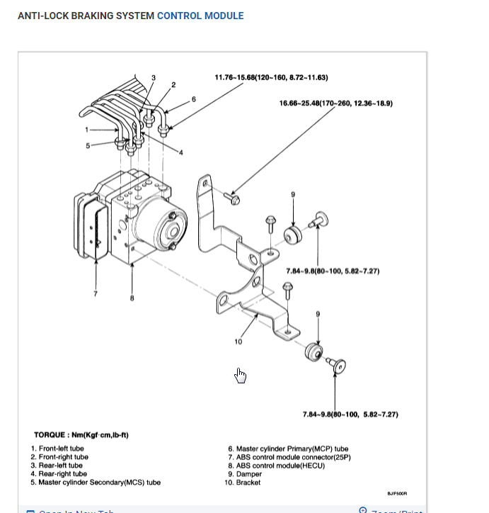

Yes. This could be an ABS issue but we need to confirm this by unplugging the ABS module and then retesting the vehicle to find out if the tire releases. Clearly you are going to have codes but they will clear once you plug it back in and clear them.
If the rear brake releases then we either have an ABS module issue or the hydraulic control unit is applying that rear caliper.
https://www.2carpros.com/articles/how-to-replace-a-abs-controller
Below is the process from the module that will show where to unplug it.
Please let us know what you find with this and we can go from there. Thanks

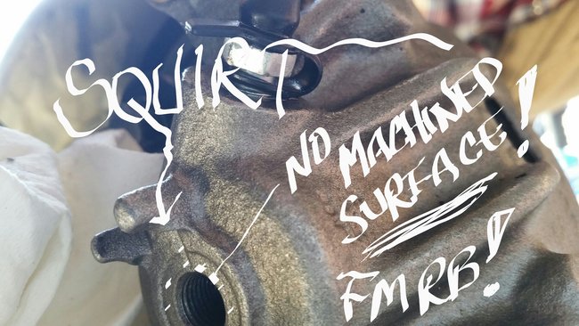

Update: stuck caliper left rear on the car listed above that has always been garaged.
After cheap aftermarket caliper replacement fiasco, see pic !...
