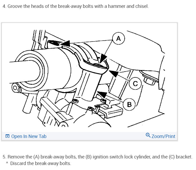

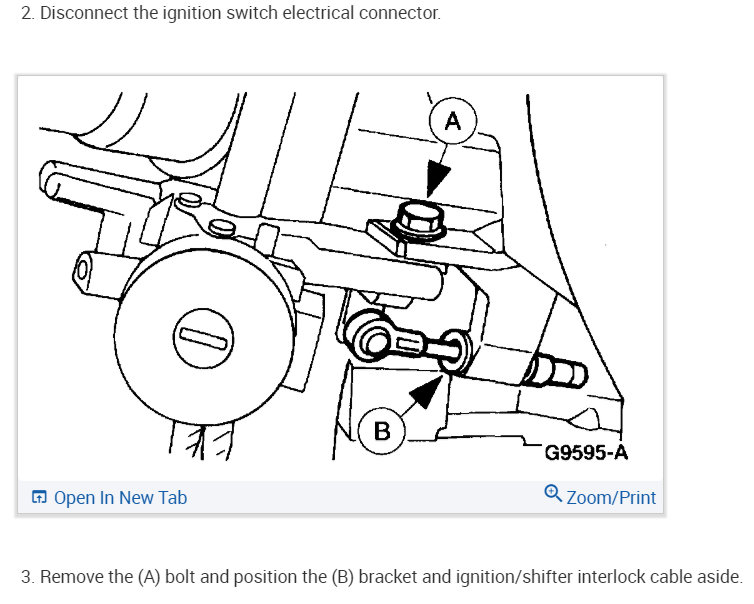

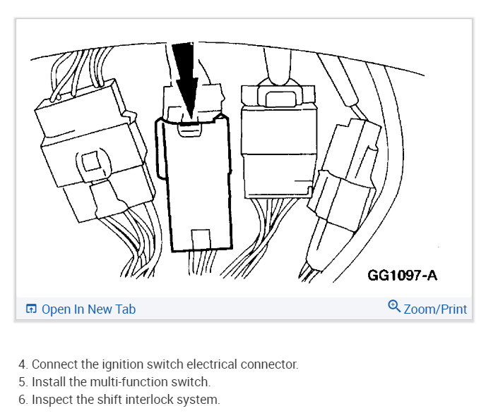

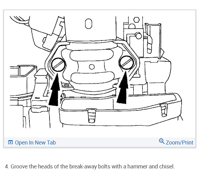

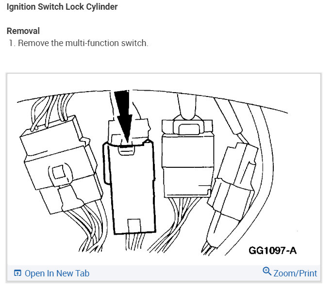

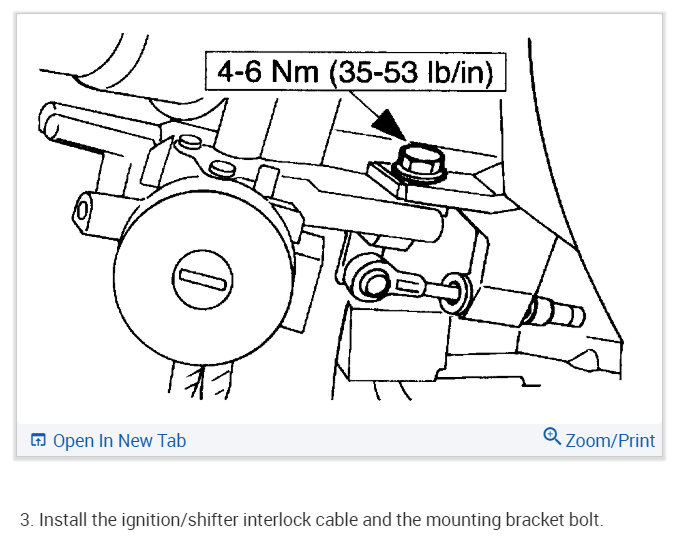

Key is stuck in ignition
2000 FORD ESCORT
200,000 MILES • 2WD • MANUAL
JEWELZ8701

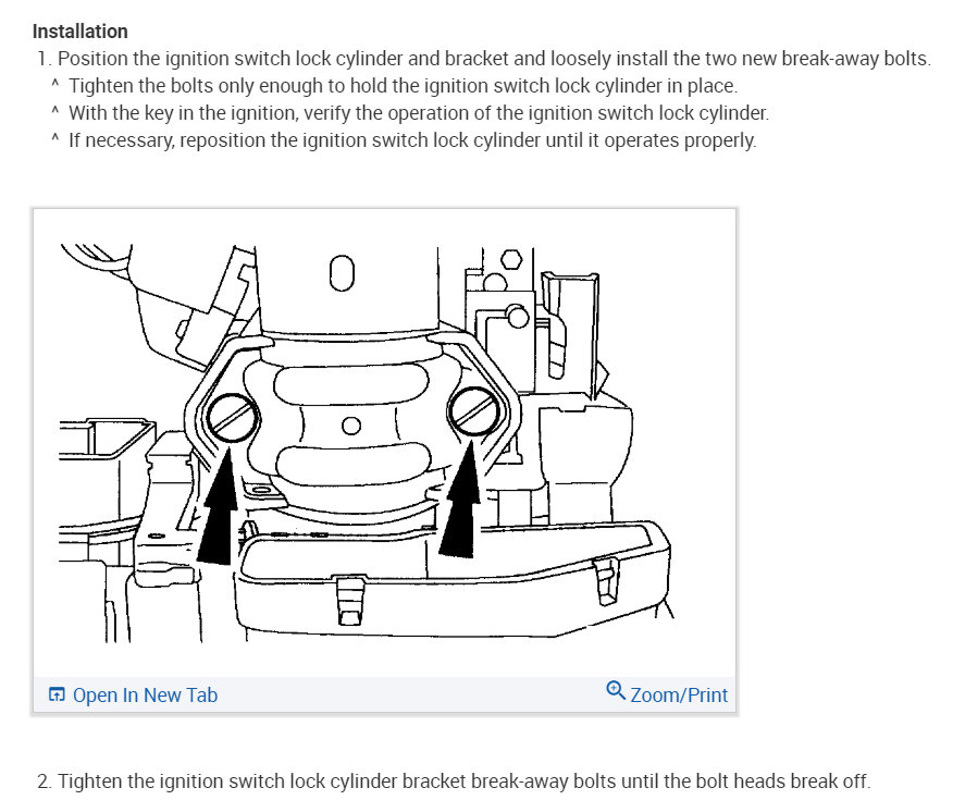

Can't push to turn key to off position and take out. The listed above is a zx2 5 speed.
Jul 27, 2019 at 12:28 PM
  • 55,402 POSTS
It sounds like the ignition tumbler has worn out. here are instructions and diagrams below to show you how to replace the unit. be sure to get the new unit from the dealer and bring your VIN so they can code it for you before the installation. Check out the diagrams (below). Please let us know what happens.
