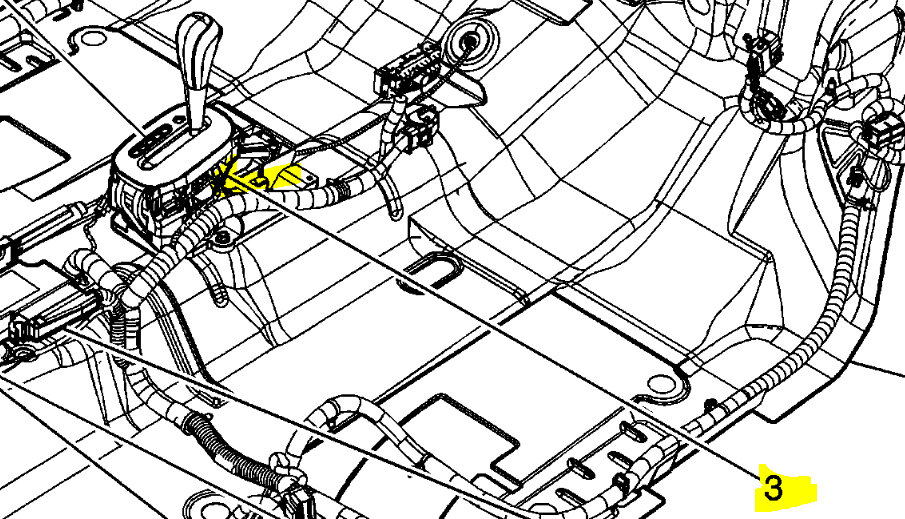

The transmission is stuck in park. I can turn it on and off, but it won't shift out of park. I checked my brake lights, and they work so i was wondering if y'all know what i can do to fix it?
Aug 23, 2024 at 6:37 AM
  • 110,244 POSTS
The shift lock actuator must have either failed or lost power. When you press the brake pedal with the key in the run position, do you notice a click at the shifter?
There is a shift lock solenoid at the shifter. (see pic below). Take notice if there is any sound coming from that area.
See pic below.

I fixed it with a bit of fiddling. Thanks :)
