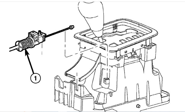

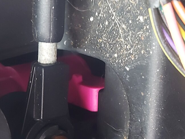

I'm finding the hook that the return spring attaches to on the lower interlock lever breaks. See pic below. See if that is still in good condition.
Let me know what you find.
See pic below.
Aug 22, 2023 at 1:50 PM
DESPERATEDAD
That is what is broken. At least i know what it is. And can depress release at front to get into gear and down to shop. Thank you (stupid plastic piece)
