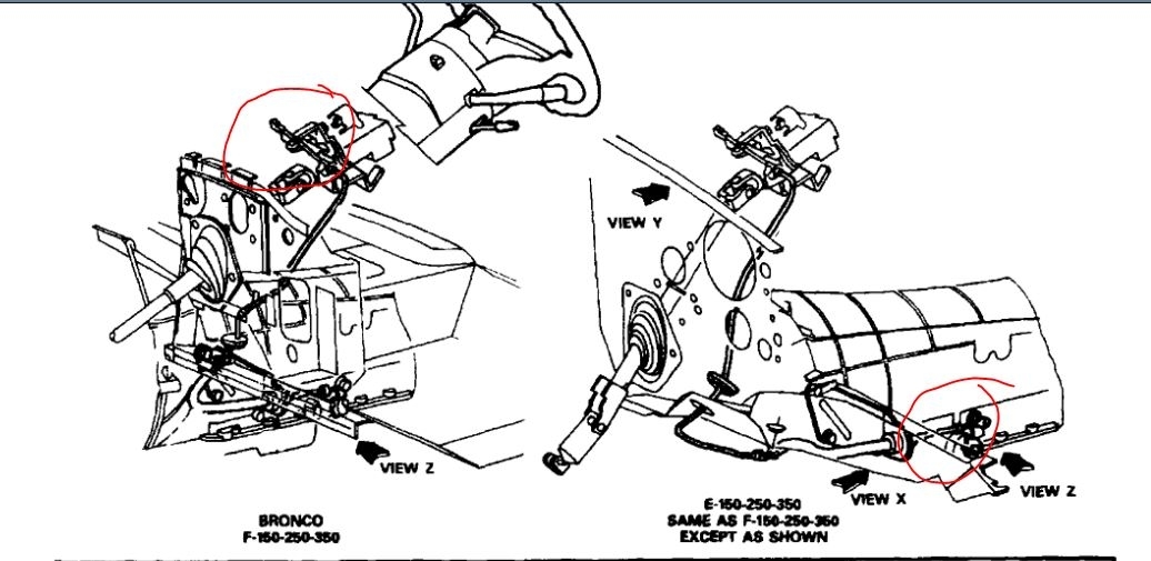

Parked and an hour later went to leave and it won't shift out of park. Where is the manual override located so I can at least move it? I have brake lights so fuse is good.

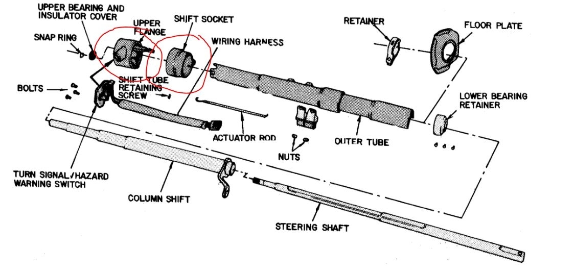

You can turn the key one position and it will release the shifter. Put it in neutral and you can start the engine.
The interlock system has an issue.
The upper collar contains the interlock for the shifter. I attached a picture of the 2 components for this operation.

No matter how the key is turned the shifter does not move. It will start by manually pushing actuator rod down but still will no shift from park.

Okay, I would disconnect the shifter from the column to see if it is a linkage issue between the column and the transmission.
You could also disconnect it at the transmission and see if the shifter moves.

Loosening a nut on the linkage allows me to manually shift the transmission but shifter still does not move.
Mar 24, 2021 at 11:25 PM
Okay, then something failed in the steering column for the shifter. It is not external, it is internal.
The 2 upper collars have to come off to find the failure.
