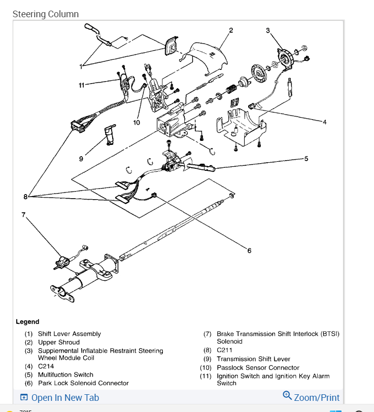

doesn't come out of park with foot on brake and taillights work?

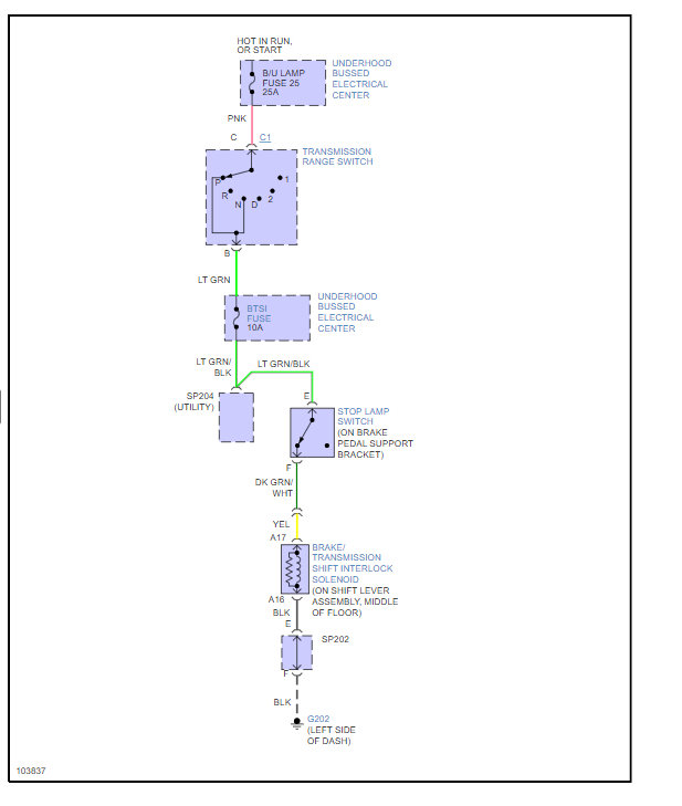

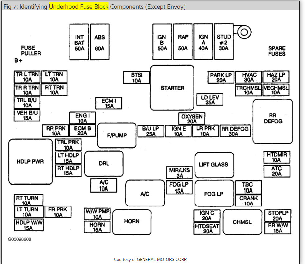

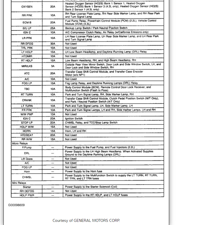

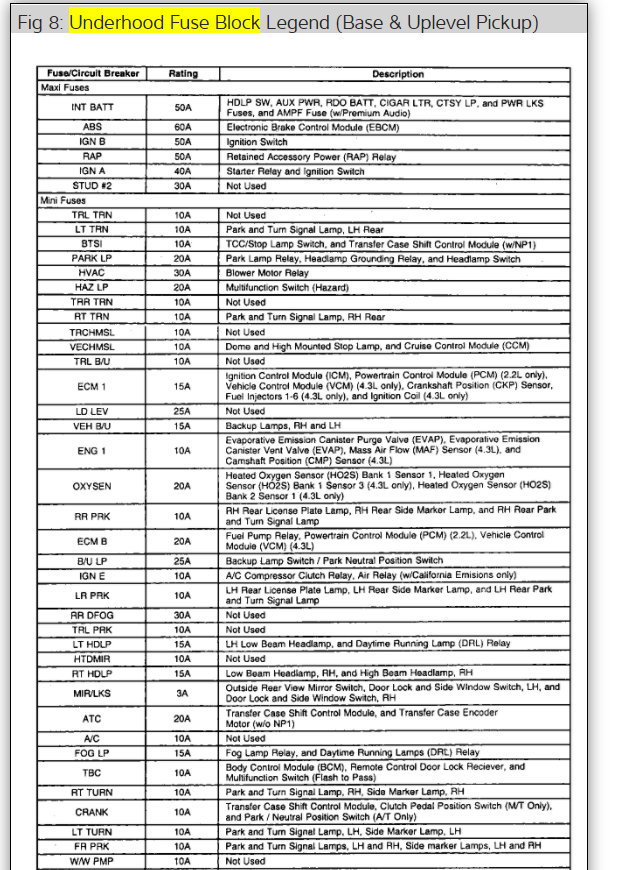

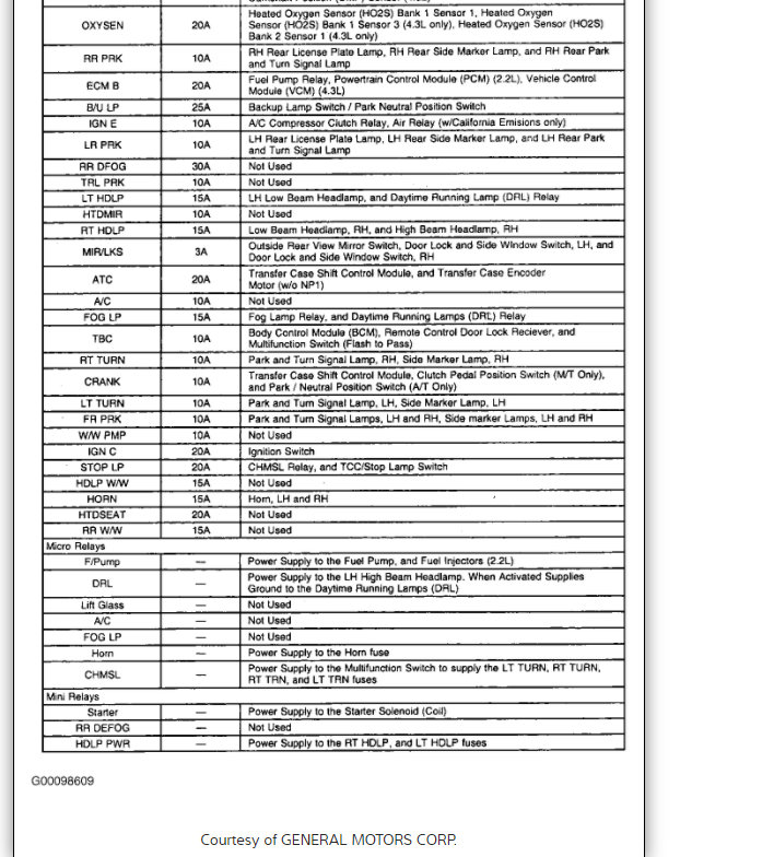

The first thing we need to do is check the fuses under the hood, B/U LMP #25 and BTSI with the key on to see if they have power. here is a guide to help and the fuse location in the images below:
Aug 27, 2022 at 3:25 AM
DAVE BOBO
both fuses have power. my shifter is on the column.

This leaves the shift lock solenoid being bad.
Here is the location so you can see if it is getting power and a guide to help you test it.
