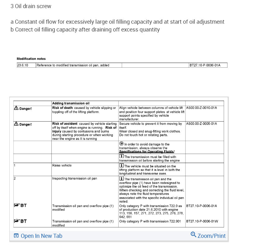

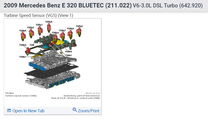

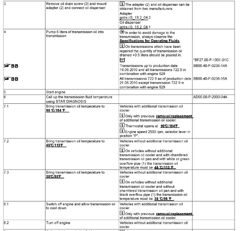

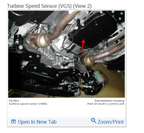

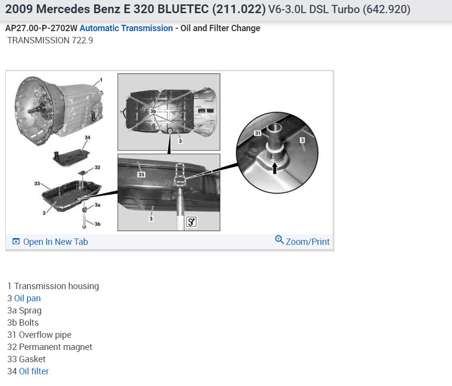

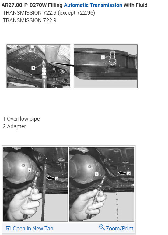

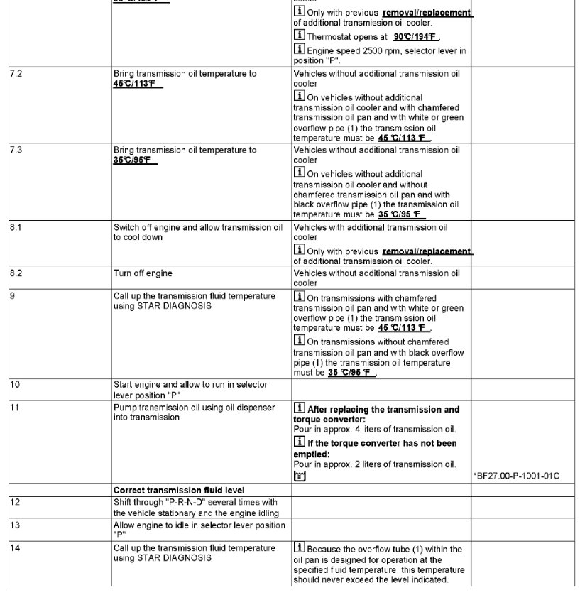

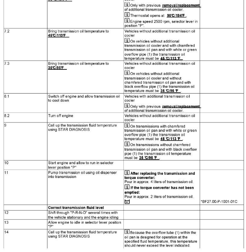

If this doesn't work the turbine shaft sensor could need replacement. Also, we should check the transmission fluid level and condition, this guide may help as well. Please check the images below for instructions on your car.
https://www.2carpros.com/articles/how-to-check-and-add-transmission-fluid
For transmission 722.55 in model 164.195 (ML 450 hybrid)
Type .................... DEXRON VI
If the fluid is burnt, I would check the fluid and filter. Here is a generic guide to help you step by step with instructions in the diagrams below to show you how on your car:

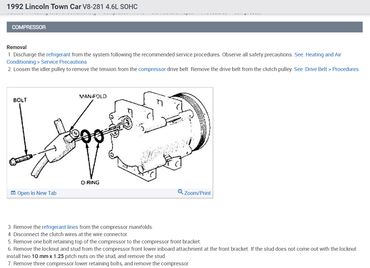

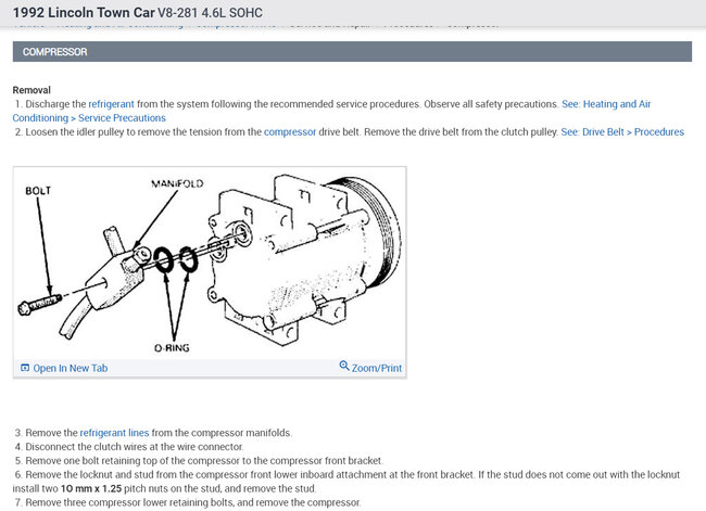

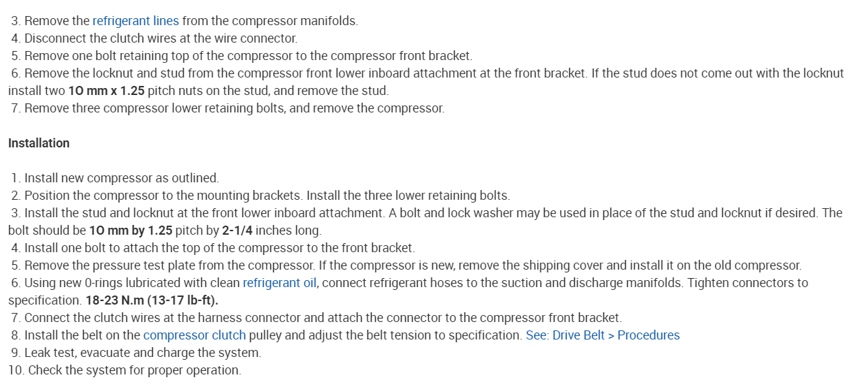

There were two pictures attached to the reply, looked inadvertent. The first two are for Lincoln A/C compressor, were there two others intended?
I have been changing A/T fluid every 40k miles, so I hope it is not the fluid, if burnt, would be an indicator of something bad.
That speed sensor is on the bottom accessible with the pan off, picture is upside down? Or is that picture identifying it right side up, have to dig through several layers to get to it?
I right side up, I have no experience rummaging though transmissions, might leave this to a shop.
