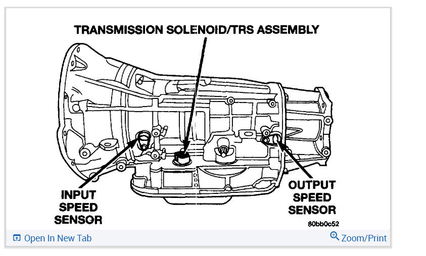

my jeep has been completely fine ,drove it to an interview today and no signs of anything wrong drove perfect. get out of the interview and start driving and it would not shift out of first gear. there are not any service engine lights on, no signs of anything wrong, no overheating and no slipping. I do not understand what is going on.
Jul 13, 2016 at 10:05 AM
  • 110,244 POSTS
First, make sure the fluid is clean and full. If it is, you need to have the computer scanned. Although there is no check engine light on, there could be a code stored. Actually, there should be one stored.
Read the guide below, it may shed some light on what happened. It may have ad signs that you missed
Jul 13, 2016 at 12:55 PM
RIVERMIKERAT
  • 6,110 POSTS
It sounds like the input shaft speed sensor has gone bad but to be sure here is a guide to scan for codes and the location of the sensor. Check out the diagrams (Below). Please let us know what happens.
