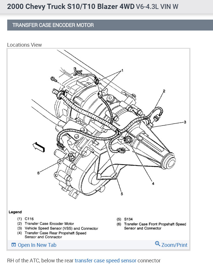

I have the vehicle listed above s10. It is in 4wd hi, unless I remove the fuse. Can any one tell me what the problem could be please?

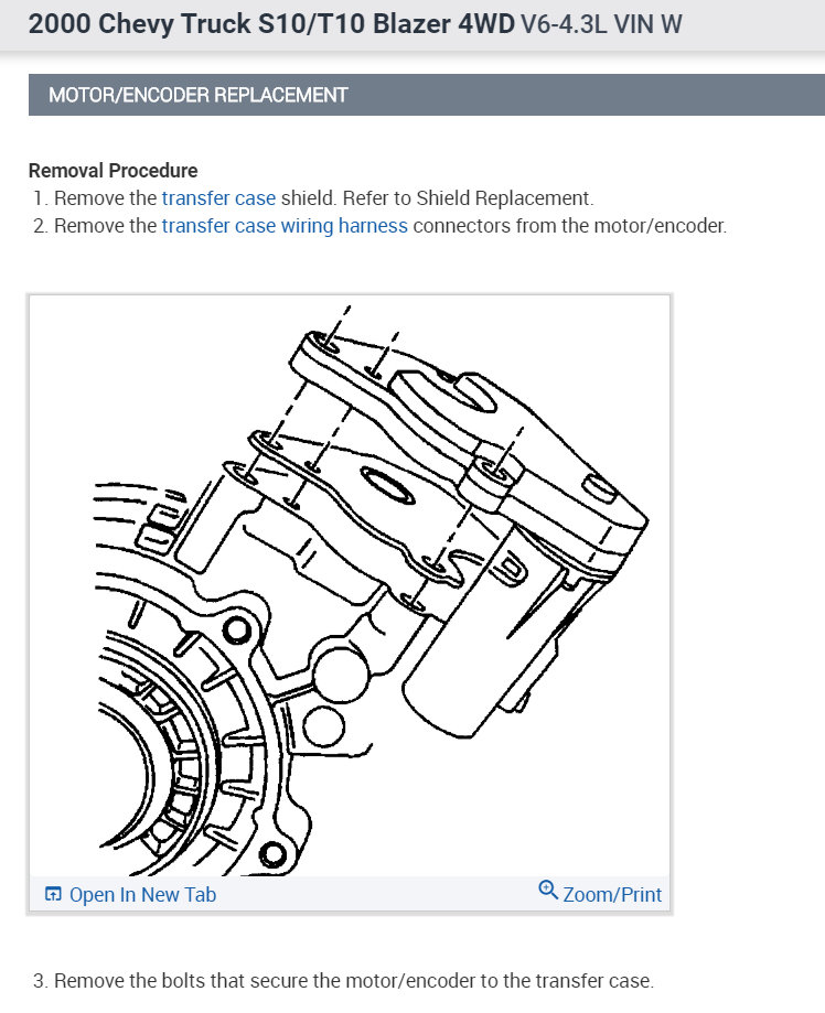

Yes, we just had this problem it was the actuator itself was bad. here is instructions on how to fix it. Check out the diagrams (below). Please let us know what happens. Can you please shoot a quick video with your phone so we can see what's going on? that would be great. You can upload it here with your response.
