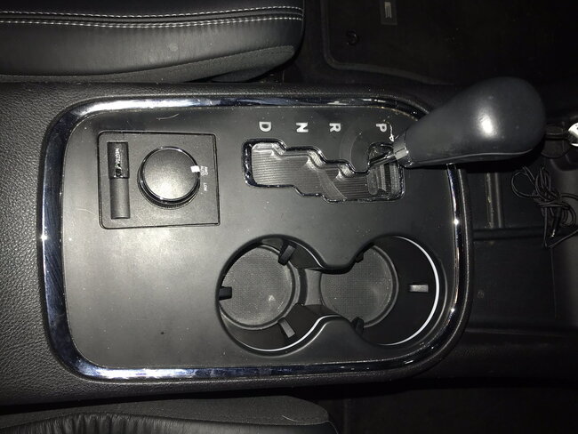

The other day when I started up my vehicle and began driving something totally fell off on my vehicle. I then realized that the 4 Low light was flashing on my dash. I have young kids and there have been a few other instances where my 4wd knob had been knocked into the 4low position and I just turn it back to the all-wheel drive mode (not sure if that's what it's called but it's the regular setting that I always drive in). So I thought maybe that's what had happened again so I turned the knob and it wasn't going back out of 4low so I tried a few different things such as driving forward a little bit and then reversed a bit, I tried putting it in neutral, and whatever else I could think of to try and get it out of 4low but no luck! So, I ended up just parking it and I haven't driven it since because I don't want to mess more things up by trying to drive it in 4low. On a side note, one of my daughters confessed that she had spilled her drink near the switch the day before but wiped it up before I saw. So, I don't know if that has something to do with what's going on or not. Any ideas where to start or what to do as I can't really afford an insanely high mechanic bill at the moment.

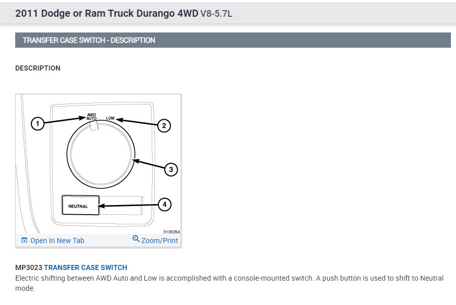

If the switch got wet, it may have shorted. Especially because of positioning, a drink could have damaged the switch.

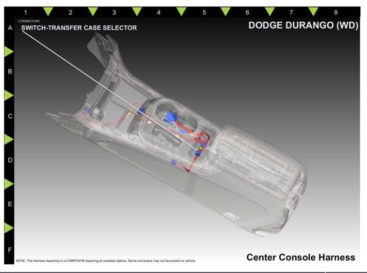

What I would recommend is to first remove the switch and make sure everything is dry. You should be able to use a flat screwdriver to gently pry up on the switch panel to remove it. When you do this, make sure you use a rag or something to prevent damaging the vehicle.
I attached pics below. Let me know if that is where your switch is located. There were two different designs.

Thanks so much for replying to my question. I really appreciate it. So here is a pic of where my transfer case switch is located.

You are very welcome. Remove the switch and check the connector to make sure nothing is wet. Let me know what you find.
